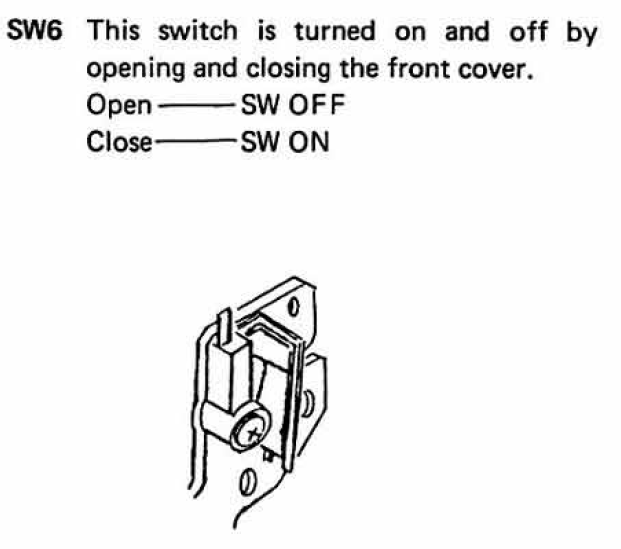

An Olympus XA service manual and exploded view are available for free download at learncamerarepair.com.
There is obviously an interlock between the door and shutter button since one cannot fire the shutter with the door closed. I don't know if the click of the door and the interlock are related.
I’d wager that they are. I’ll post what I find.

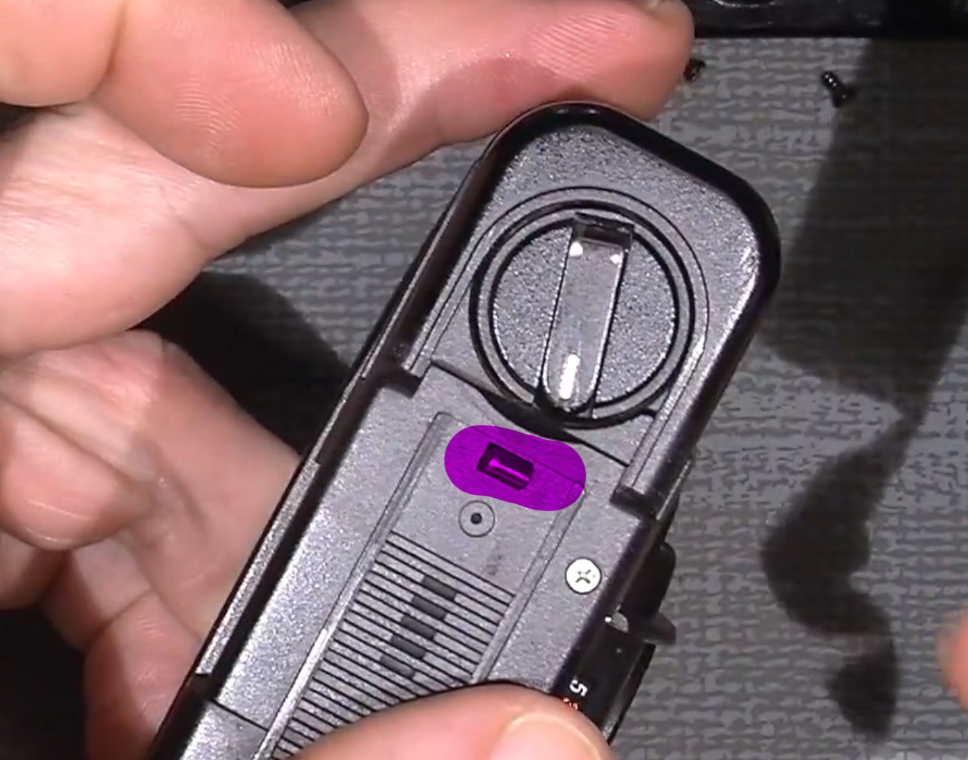

The piece in the XA isn't a ball, it's a small rod. A ball will not sit properly in the slot.
Here's a link to the spot where he opens the top and you can see the roller bearing.
KerrKid
KerrKid
Feb 5, 2022
1,512
Kerrville, TX
.Very true. I would be looking for a roller bearing and not a ball bearing. We have a great hardware store here that usually has things no one else has, so maybe I can find one there. No problem as the aerosol straw is always an option.
Question: If this bearing was missing would it cause the slide to move back and forth freely and not "click" shut?
Thank you for the photo of the bearings location. I had no idea it was there. I will check out the video.
