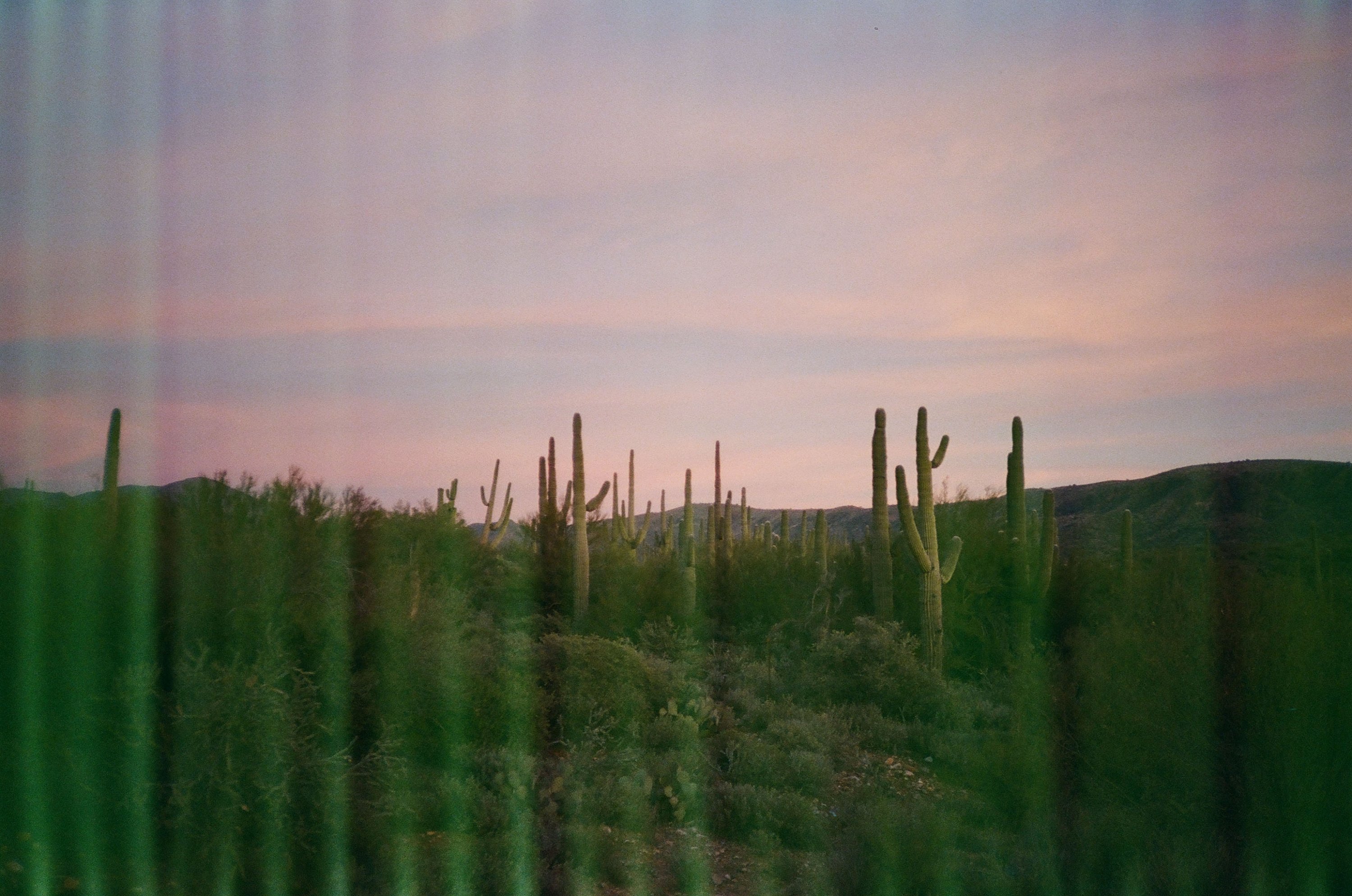

Hi all,
I just got some scans back of a roll of Portra 800 I shot with an Olympus XA and needless to say, I am super bummed. I have shot many rolls of that film with that specific camera and never got any issue in the past. The only new player in the process is the lab. On most shots -not really depending on exposure- I get those green vertical streaks across the photos. It is more visible in the low-light areas but I have it across all shots, even in highlights. It also happens throughout the roll, not necessarily more at the beginning or the end.
This roll was developed and scanned at a new location I have never worked with before, so I am trying to understand where the issue is coming from.
I appreciate any insight you might have. Thanks!

Looks like a scanner issue.
I agree. Someone needs to improve the filtering in the power supply for their scanning light source. Show those images to your lab, they should give you a rescan at no charge (insist that they fix their power issue first, obviously).

We have have to see the negatives and it is probably a scanner issue. Talk to the photo finisher.

As everyone has mentioned, need to see the negs to be 100% sure. But the camera can't do that to the film so either the lab bolloxed your film in development, or they messed the scans. Or both.

Sounds like BS to me. The streaks aren't spaced 8 to the frame as the perfs are. They're much too close together.

Yeah, I count 25 streaks. This actually makes it worse, as now they are trying to pass the buck on their mistake.
Correct response would be 'sorry we messed up, let's make it right'.

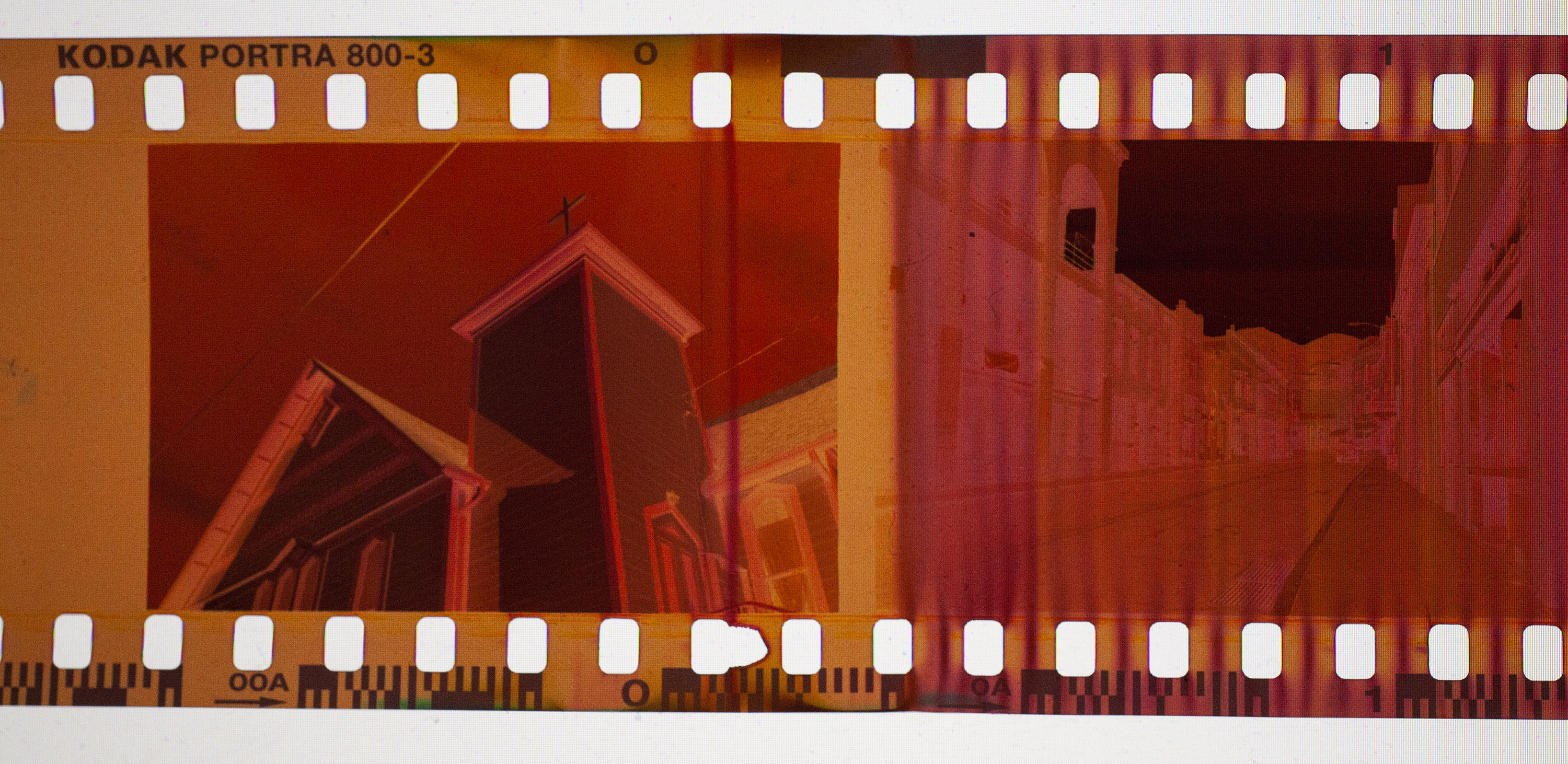

Hi all, following up on my issue here. I got the negatives back and the same stripes show on there so I am not sure what happened. Seems too linear to be light leaks to me but I am also not knowledgeable enough to be certain. I did notice the issue started past that damaged hole you can see on the photo, the film is also bent a little in that area. I guess I am just trying to understand where it came from so I can either fix my camera, not re-do the mistake I might have made...etc. Just trying to figure it out before I load another roll.
Let me know if you have any insight or advice, thank you very much!
Sirius Glass
Jan 18, 2007
50,500
Southern California
You need to take these negatives back to the photo finisher and ask them what they did to cause these streaks. Bring the earlier films too to show that the problem is not an one off problem. Among others things the photo finisher needs to replace the damaged film too.

That looks like a machine-stop, processing failure to me.
I know of no earthly way a camera could cause that issue...
Huss
Feb 11, 2016
9,058
Hermosa Beach, CA
They owe you a roll of film and an apology.
There is zero way you or your camera did this.

That definitely looks like light fogging from here, but I agree, your camera couldn't have done that. To me, it looks like a bad light seal between a cassette and machine, possibly triggered by the damaged sprocket -- but their machine should be able to tolerate that level of damage, surely with no worse effect than damaging a single frame at the point the damaged film passed the light seal. If it's happened on other rolls as well, it's a systematic problem with their machines.

Ending this thread with the lab's response after seeing the same photo of the negatives I posted:
I can honestly say I see this everyday that I'm here and it's not exclusive to Olympus XA. I also have this same old point and shoot and I love it. If you look at the sprocket hole near the zero mark at the bottom you can see that's it's torn. The teeth didn't catch the film sprockets and that could be for many reasons. When it happens at the beginning of the roll it could be because it wasn't loaded properly, when it happens at the end of the roll it's usually on rolls where the shooter tried to squeeze a few more exposures on the roll.
So I guess I'll never really know what happened :pouty:
But thanks y'all for helping out and happy new year!

When I saw the sample you uploaded, my first thought was kink/stress marks. Does the film show any kinks where there's increased density? If yes, that would explain it.

If I were face to face (even through those acrylic barriers businesses often have up these days) I'd ask how the devil he thinks the single torn sprocket hole is the problem, when I'm asking about the stripes running across the print?
