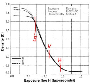

Thought it would help illustrate the concept to show a characteristic curve with some points marked out on it.
This example curve is from Fuji spec sheet for a favorite slide film of mine (Velvia 50).
It's been said (and not refuted) that the OM-4 reduces exposure by 2 2/3 stops for spot-shadow. And increases exposure by 2 stops for spot-highlight.
An unmodified spot meter reading would strive to place -0.8 Log lux-seconds on a 50 speed film.
I marked an unchanged spot meter reading as "V" for Zone V.
2 2/3 stops less exposure is -1.6 Log lux-seconds, and I marked that as "S" for spot-shadow.
2 stops increased exposure is -0.2 Log lux-seconds, and I marked that as "H" for spot-highlight.
As shown, spot-highlight would not be a blown-out highlight.
The spot-shadow would create a very dense 3.0 shadow with color slide film, so not as relevant to proper slide exposure to use spot-shadow.
But for black and white film, I checked what this same displacement would create on black and white film, a density about 0.16 which is a good shadow density.
I would conclude that if you want to use the OM-4 exposure modifier buttons with the spotmeter, it is best to use Spot-shadow for black and white film... and use Spot-highlight for color slide film.

OK the manual uses the word "overexpose" which is unfortunate choice of words, because it made me think you said something wrong. Even Ansel Adams didn't like using that word when talking about where you place exposure, he preferred "increased exposure" and "decreased exposure".
It was your post #15 where it sounded to me that you told Svenedin that using the "HI.LIGHT" button was the wrong thing to do. If you meant to confirm Svenedin's understanding then I apologize I don't mean to speak out against your really good story... You know me, I much prefer to be encouraging and say "that's right! You got it." So let me know if it was just a misunderstanding.
I wanted to reassure Svenedin it would not overexpose the film, it would be the right exposure.
Intuitively to me, the "HI.LIGHT" button was designed to bring exposure to a really good place for bright parts of the scene for color slide film.
I wasn't sure where "SHADOW" would place the exposure on color slide film...
Basic photo books give general advice assuming that you are using an average meter.
With your OM-4 you have a spotmeter, where the general advice still applies but you can be more specific.
Because Fuji included specific exposure numbers on their graph, I was able to draw lines where a meter would put "ISO 50", "2 steps" increased exposure and "2 2/3 steps" decreased exposure.
Then my interpretation of the graph is...
Two stops increased exposure from meter reading is great for highlight placement on Fuji Velvia 50 because there's still a little room for brighter objects to go brighter.
I was surprised how dark the spot "SHADOW" button places the exposure on a Fuji Velvia 50 color slide, so I wouldn't recommend it for that black cat on color slides... I would reserve that button for black and white work.
