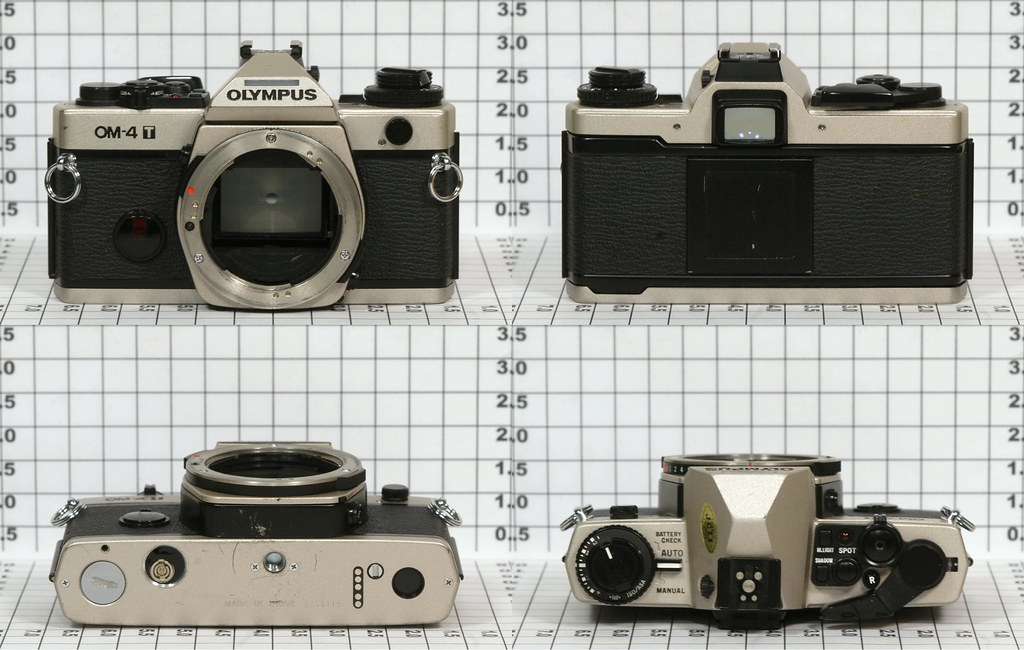

I just confirmed this on mine. The OM-4 has two completely mechanical shutter speeds 1/60 and B. With batteries depleted/removed these two settings will always be able to fire the shutter. On all other shutter speed settings - including a 1/60 electronic setting, and the batteries go dead, the mirror will stay up as expected. To release it, you will set the shutter on either mechanical settings of 1/60 or B, and press the reset button underneath.

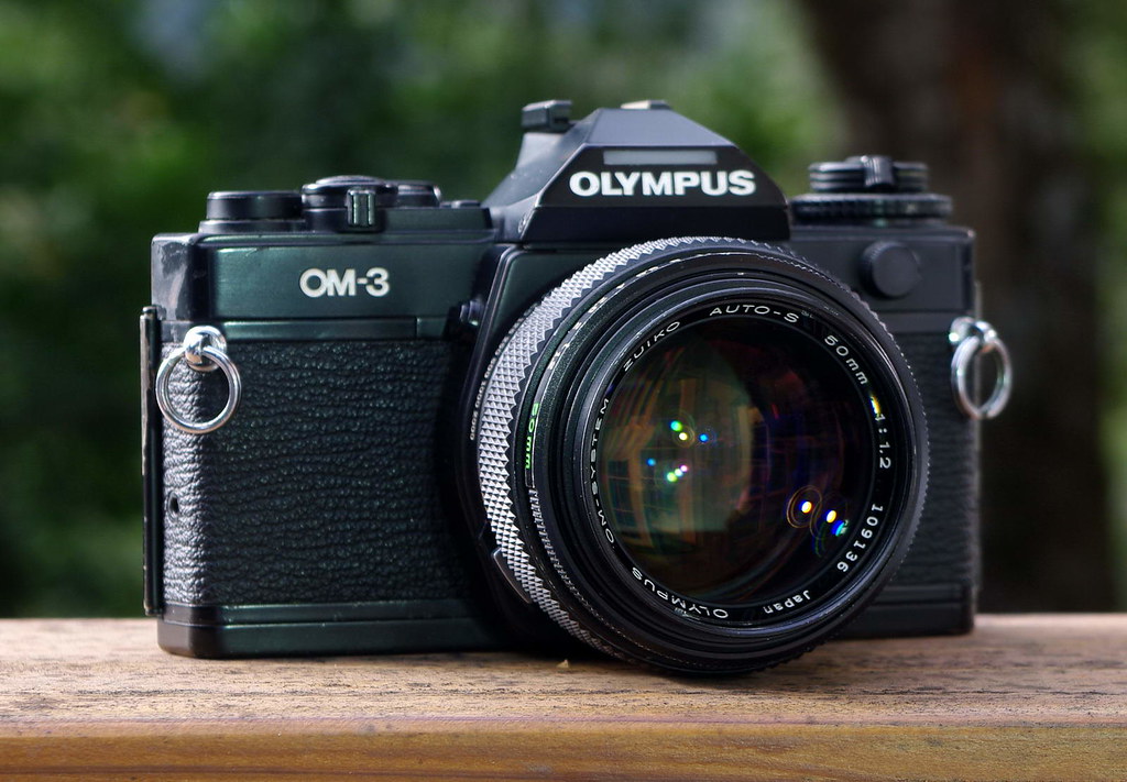

The OM-4 acts more like the FE/FE2 in that there are two mechanical shutter speeds that will allow you to operate the camera if batteries die - B and sync speed. Of course the OM4 has a far more sohphisticated spot meter then any other manual focus camera. The OM3 has the sophisticated metering of the OM4 but no aperture priority autoexposure and has all shutter speeds available when batteries die.

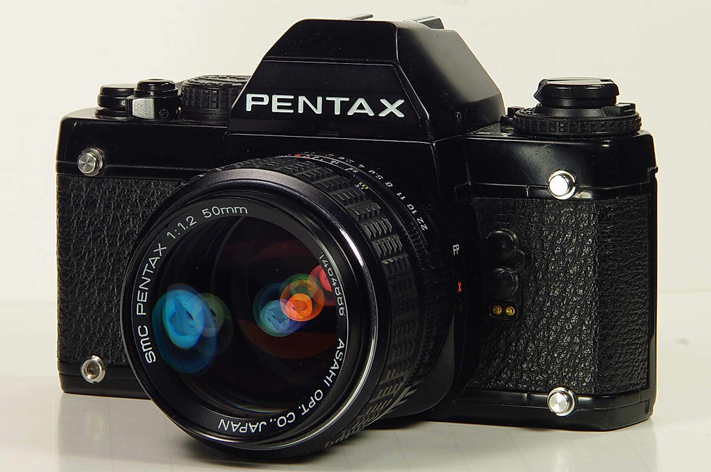

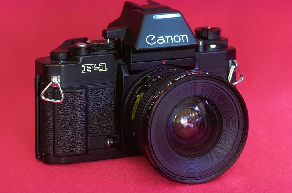

There are a couple of cameras that have aperture priority autoexposure and sync speed + all lower speeds available when batteries die and those are the Canon New F1 and Pentax LX.
