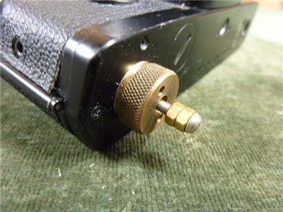

I was amused to see the following mod on an OM-4 I found for sale.
The thumbscrew relieves pressure on the batteries to break the circuit and stop drain. I like it! Although I would think it could be made significantly more compact.

Not 100% sure, but does the motor drive/ winder power the camera and allow it to run without batteries? it's quick and easy to pull out the battery tray/pack. There pretty small and provide a nice grip.
