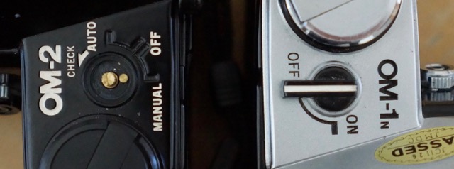

DSC01179.jpg On my OM2 the little plastic piece that switches between "Manual" "off" "auto" and "check" just broke off and then the plastic remnant fell out. I have an OM 1 that's basically shot -- is the little plastic lever the same -- and if so, how would I swap it out? Attached is a photo of the top of both cameras with the knob/lever missing on the OM2.
See that flat on the OM2 shaft? Look at the pieces, there should be a spring the size and shape of the shaft that fits inside of the lever, if it is missing it might explain why it broke. Some knobs may have a piece of flat spring steel on the flat only. If thery're the same the OM1 lever should pull off by lifting straight up with a slight rocking side to side. Removeit and check, it just presses on.

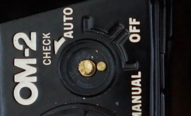

OM2.jpg There isn't a flat -- the shaft is knurled (if that's the right word), it has grooves that run up and down. I don't think a spring was in there. I put the two pieces that broke side by side and it just looks like a hole is there to receive the shaft. I also am a little confused as to what the vertical post next to the knurled shaft (which is lower) does. I don't see a second recess in the broken knob (lever). Perhaps the knob sits above that? I tried turning the shaft with a screwdriver as it's slotted and all the functions work. He's a blown up pix. I tried to pry off the lever on my OM1 but just managed to chip it. Could they have glued them on? I wonder if I could fabricate an aluminum, plastic or hardwood piece and affix with a tiny drop of epoxy?
Snip off a bit of a paper clip and superglue it in the grove. :smile:
Groove is too small for a paper clip -- jeweler's screwdriver size. But superglue might be a good idea. I am paranoid about excess glue getting in and gumming up the shaft and it not turning freely. Wonder if there is some knob available or that I could make with a set screw to hold it in place.
Light/lens angle made it look like a flat. Slotted shaft is another design for positive knob lock to prevent slipping. Still the lever on the 1 is push on pull off just like the 2's.
Try it.
The pin at the rear is likely a stop, if there is no slot for it there was likely protrusions that prevented turning the lever too far.
Gently pry/pull the lever off the 1 and see what it looks like. The only thing I would attempt gluing is the broken lever parts.
