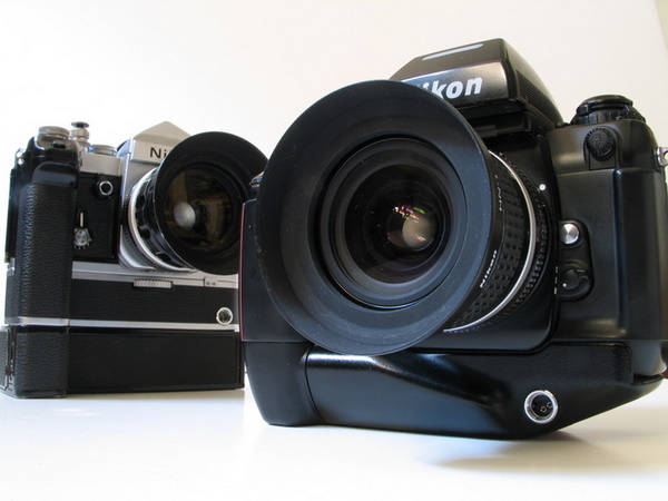

When I need an auto-exposure 35mm SLR body for low-light shooting, I use the Nikon F4.
Not only does the F4 give me the option of using aperture, shutter, program, or manual exposure modes, it also gives me the option of using auto focus or manual focus modes.
The standard viewfinder works well under dimly lit situation because it has a light that illuminates the viewfinder information.
I also love being able to remove the viewfinder and/or focusing screen and replace them with whatever I need for low-light shooting.
I have two fast 35mm lenses for low-light shooting: an f/2 and an f/1.4. Unless I am shooting in a hostile environment, the f/1.4 is my first choice.
