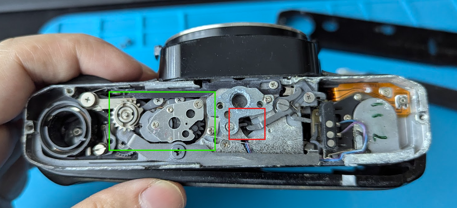

Hi,
I bought this camera on a carboot sale. I bought it cheap enough knowing that there was potential of it not working properly.
I'm trying to fix it.
The issue is that the mirror is stuck on the firing position (up position) and I'm certain is not batteries or magnets.

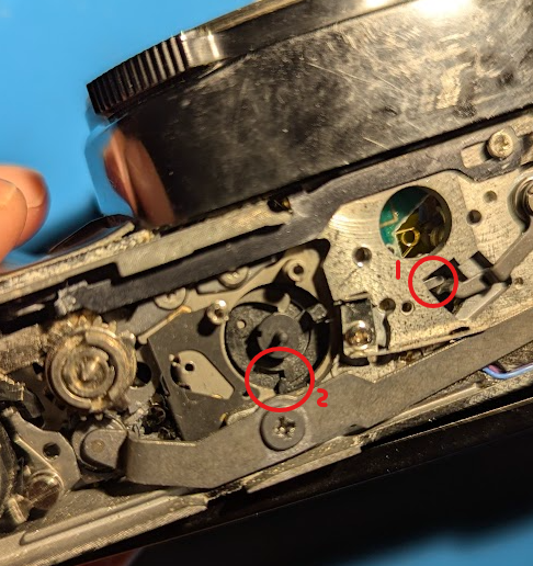

Imagine that you push the advance lever and the camera is ready to fire. Once you shoot the mirror closes and does not come down again.
You need to open the bottom and push a small lever (picture 1, in red, small protruding lever) so that the mirror comes down and you can rearm again. The idler gear seems to work fine as it turns fine with the expected fit of the "two teeth" gear.
However underneath the idler gear, the protruding lever acts on the stop you see on picture 2, circle 2. It seems when you arm the camera, this "stop" enters the opening on that gear and holds it.
When it fires, the mirror goes up and this "stop" does not go all the way back, completing its cycle and does not go back enough for the gear to unwind.
I'm not sure if the bigger arm, next to the protruding lever, is the one responsible to push it back all the way, enough to complete the mirror cycle. I took it out and checked the spring tension, and I think its strong enough that it should push the small lever without issue.
I assembled it again as originally was.
If anyone has any knowledge on this specific camera that can lay some help, I would appreciate it. I also have the repair manual, but I can't make sense out of it.
This is the mechanical issue, I'll then go to check the electricals
This would go pair well with my OM-10.
Thanks for checking and welcome any suggestions.

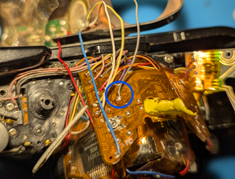

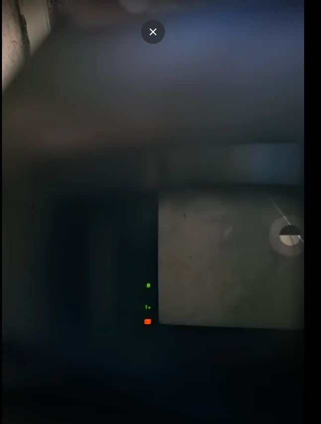

Today I inhaled very deep and started to disassemble the camera, as I was willing to go to the end and try to catalogue everything.
Thankfully I didn't need to go to the end, as at some point, by accident, noticed that by taking a screw holding the circuit above the prism, the mirror was coming down.
Immediately I though there was a bad contact, but it was not the screw in itself.
Then I noticed that arming the camera, and shooting the mirror was still getting stuck, but bending the circuit would trigger it to go down. The next step was to pinch the circuit and trying to find the point of bad contact. It was the grey wire you see on the picture. I soldered it again and it worked.
The mirror comes down every time now. The battery check beeps, and the other modes show the indicators through the viewfinder. Even the led at the front of the camera lights up.
I will have now to get the speed film speed selector correct. Its a bit loose and I'm not sure how to calibrate it now.
This mode does not seems to be around many times, but in this case, getting this far is a victory to me and having two Olympus OM could be the start of a collection :wink:
I have a Nikon FE10 to try and achieve the same results as this one.
I hope it can help anyone with a stuck mirror where the solution is quite different from the usual ones.
Thanks, I really appreciate all the help!
