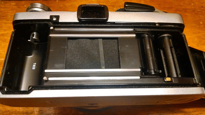

- the shutter curtain is basically half way across its travel. I tried turning the mode knob to reset but that didn't seem to free it up. If I gently try to advance further, I can see that the top of the shutter curtain looks like it moves to the right just a bit, but the bottom doesn't move.
That symptom is shutter curtain snapped or detached not an interlock problem.

I tried looking at the gearing and seeing if anything was jammed up but it doesn't appear so. Xmas, seems like you've got the right idea!
I've since started disassembling my "junker" OM-2n, to learn more about how it goes together so I don't needlessly turn the good camera into a real-life exploded diagram. If it gets too hairy I might end up scrapping the plan and sending it off to KEH (their repair lead time is much better than what other places are telling me). Of course, for the $200 job, I might as well buy a new body... I'm not particularly attached to this one yet. We'll see.

FYI for those interested, here's a picture of what the shutter looks like:
So sad.

Think the gel is a premium US auto grease with PTFE, thin oil ditto, don't do curtain repairs to OMs, life is too short,...
Haberdasher store for ribbon with same form - only replace broken one.
You may want to make up the stereo shutter timer.
