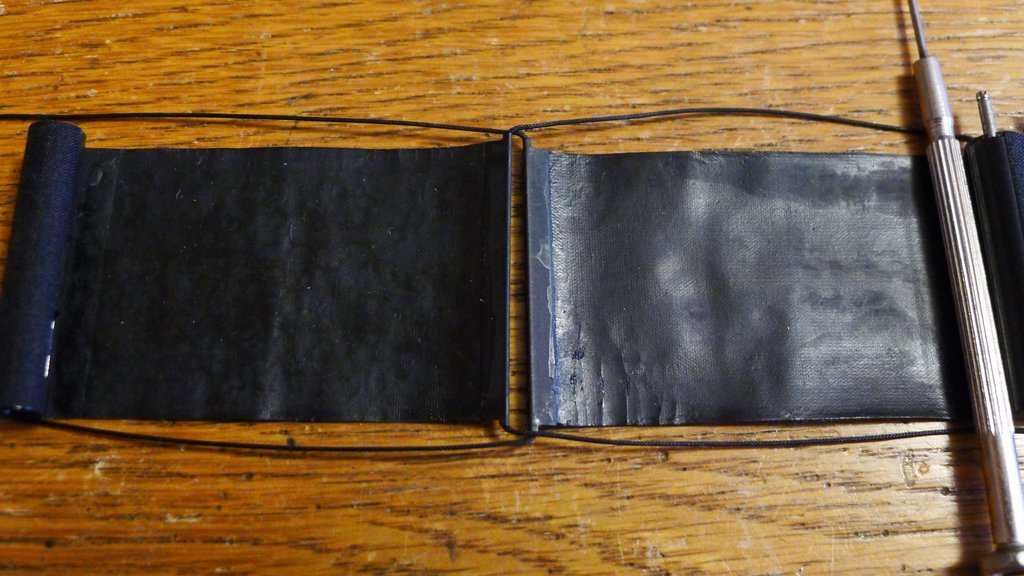

I had one OM-1 in which the shutter curtains dried out, the ruberized side was full of cracks and generally not as flexible as it should be.
With the 'Camera Craftsman' article and Olympus service manual at hand I managed to replace the curtains.

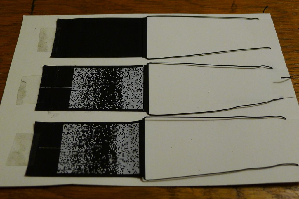

The original replacement curtains from Olympus would come already attached to the rollers, however I only had spare curtains from broken OM-10 and OM-20(G) bodies.
From OM-10 the opening curtain can be used as it is glued to the take-up roller, but the winding rollers are different and need to be transferred and glued to the original OM-1 winding rollers.
The OM-20 (OM-G) take-up rollers are mounted in the body upside down (the star nuts are up) and therefore can not be used at all.
I used the black curtain from 2 parts bodies. The dotted curtains can be used just as well, and if I ever need to replace the curtains again I will use the ones I have.

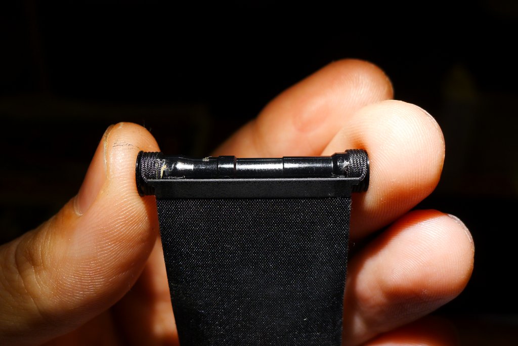

The most complicated is to reglue the opening curtain strings to the winding roller. I noted the position of the curtain edge when the string was fully wound to the roller, then when attaching the good curtain I first fixed it only by electrician's tape to find the position for string ends, then checked the position of the curtain edge, then glued both strings at the same line (the strings are same length).

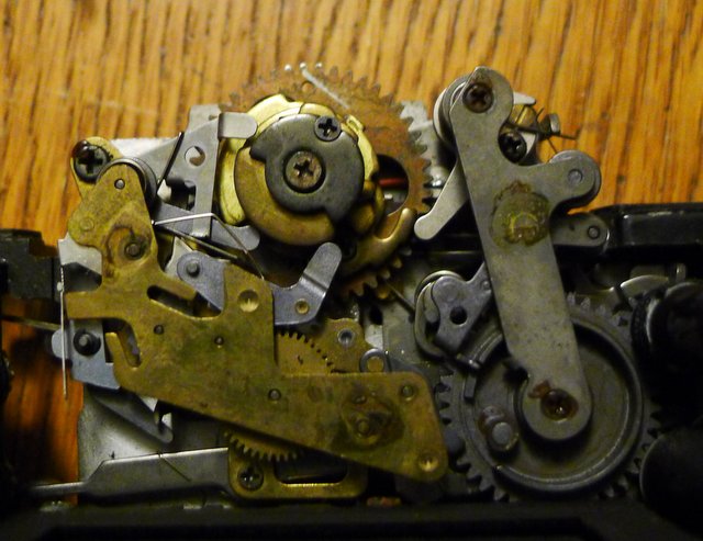

Now back to the original topic = changing OM-1 shutter curtains, I just tested the shutter speeds. After setting the spring tension enough for the curtain to travel across the film gate in 12ms (as specified by Olympus in the service manual) the speeds 1/60, 1/125 and 1/250 are all within 4% of the correct value! 1/500 and 1/1000 are more than 20% off, but there are separate adjustment points for these 2 speeds by bending parts of the brass high speed selector disc.
BTW: adjusting the speeds should be done by first setting tension to match the 12ms travel time, then adjust slit width at the highest speed which is not individually adjustable (1/250, but on some older samples it is 1/500 like in the following picture) and then the fastest speeds individual adjustment points.
