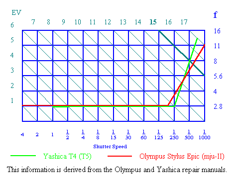

To Pentaxuser, by the open aperture thing I mean once shutter speeds begin to climb beyond, say, 1/125th, I would normally expect aperture to begin to stop down in staged increments. The MjuII holds on to f2.8 some way past this, I forget exactly how long, I had a chart somewhere. It's really only an issue with slower films and/or low light, with ISO 400+ in good light the aperture allows a bigger DoF.
Here is a view of the Mju II exposure program.

This was the result of auto-focus technology. If you check on older "auto" cameras (e.g.the Trip 35), they were designed to close down the aperture for maximum DoF. This meant that the shutter speed would be about the slowest recommended for the lens focal length (the Trip used 1/40 sec for a 40mm lens). Once auto-focus came around, the camera companies apparently decided that camera shake was a big problem (had it ever been a problem before?) and sacrificed the DoF for faster shutter speeds. It is a pain in the butt if you know anything at all about using a camera.
