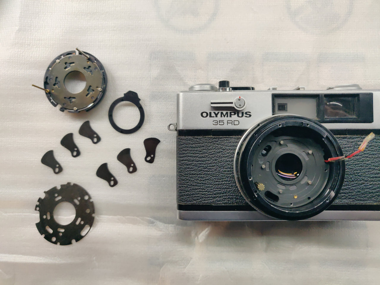

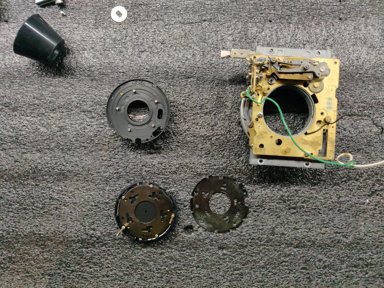

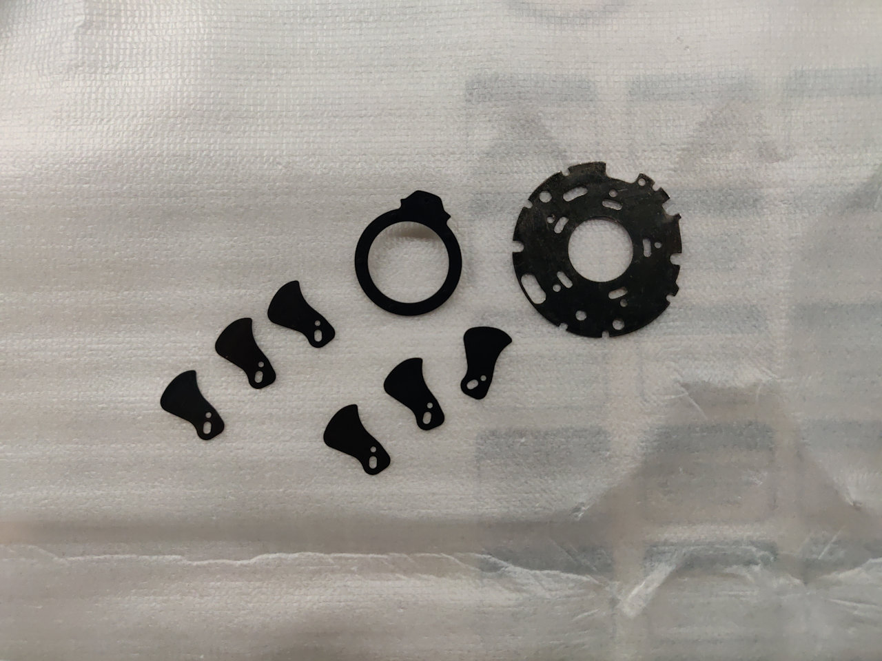

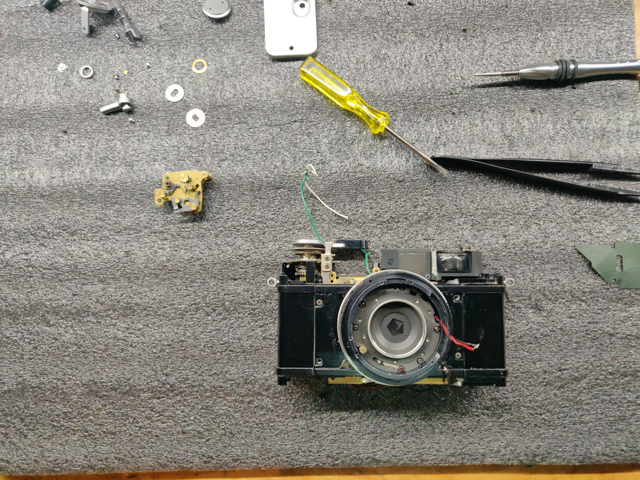

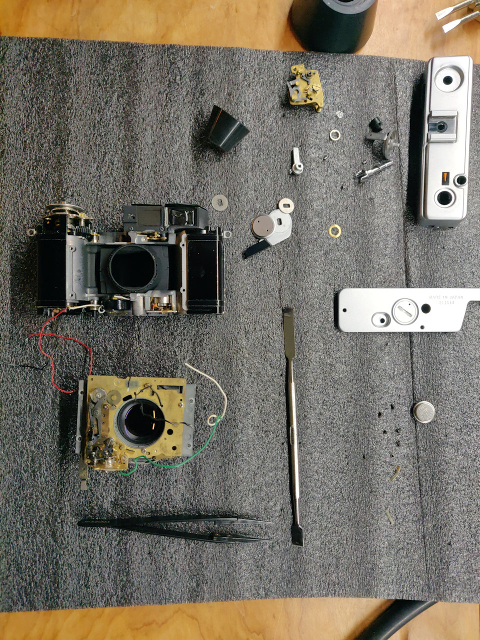

I just picked up an Olympus 35RD knowing it had a shutter problem. Cosmetically it looks great and I gambled on it being repairable. When I got it, the shutter stuck open at all speeds, seems to be a common problem with the RD. I tore into it and cleaned the shutter blades and flushed out the clockwork. While in there it was obvious someone else took it apart, the aperture return spring was missing. I noticed something off with the aperture when I first got it. Fortunately I had a spring that works in my box of bits.

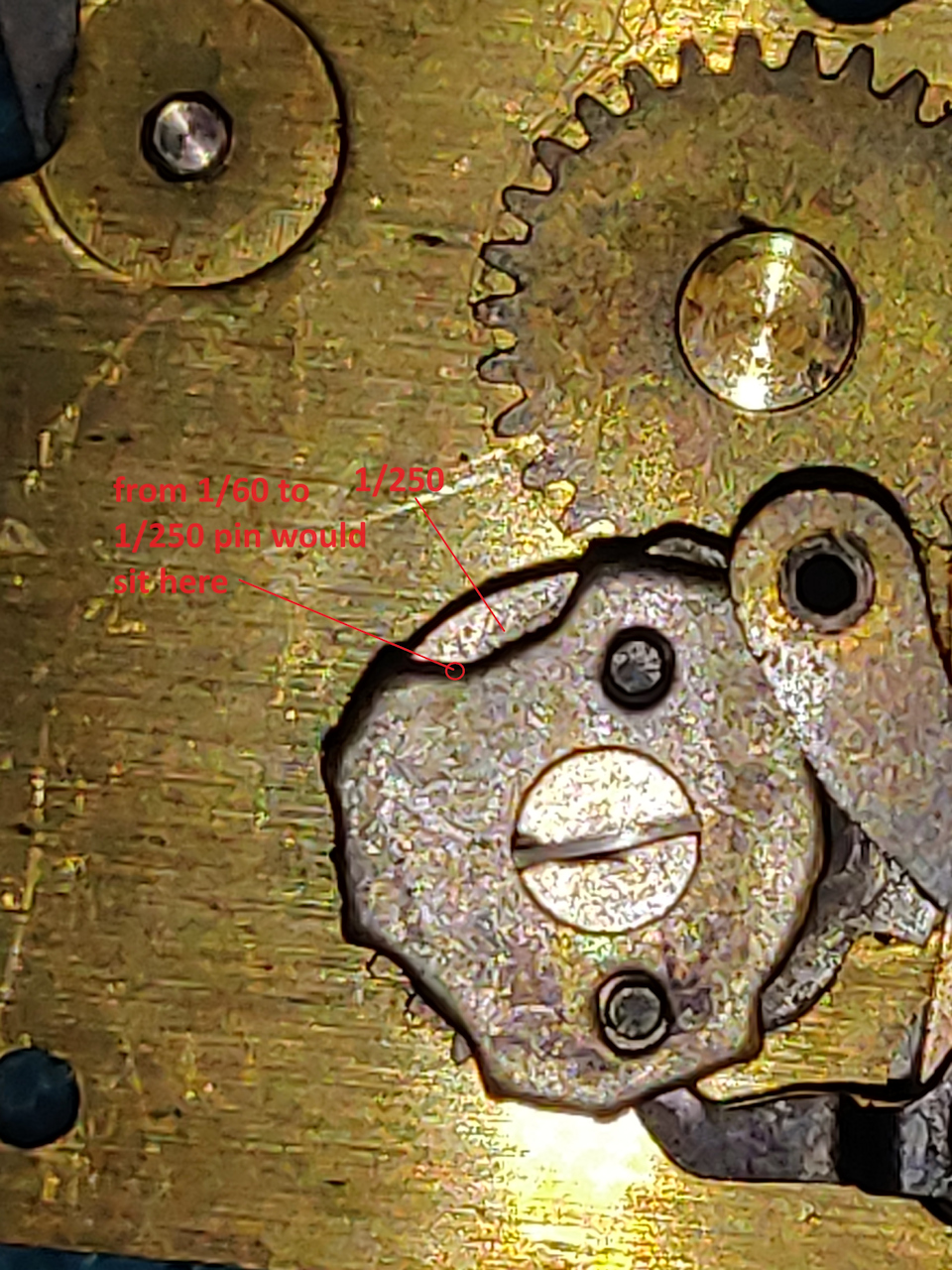

Got it back together and now the shutter works fine but seems I need to do more than a simple cleaning of the clockwork. 1/125 seems to fire closer to 1/60, other speeds seem OK. I'll take a look and see what's special about 1/125.
Some random pics, I always start thinking I'd take photos of the process, but then once I get started I just keep at it.

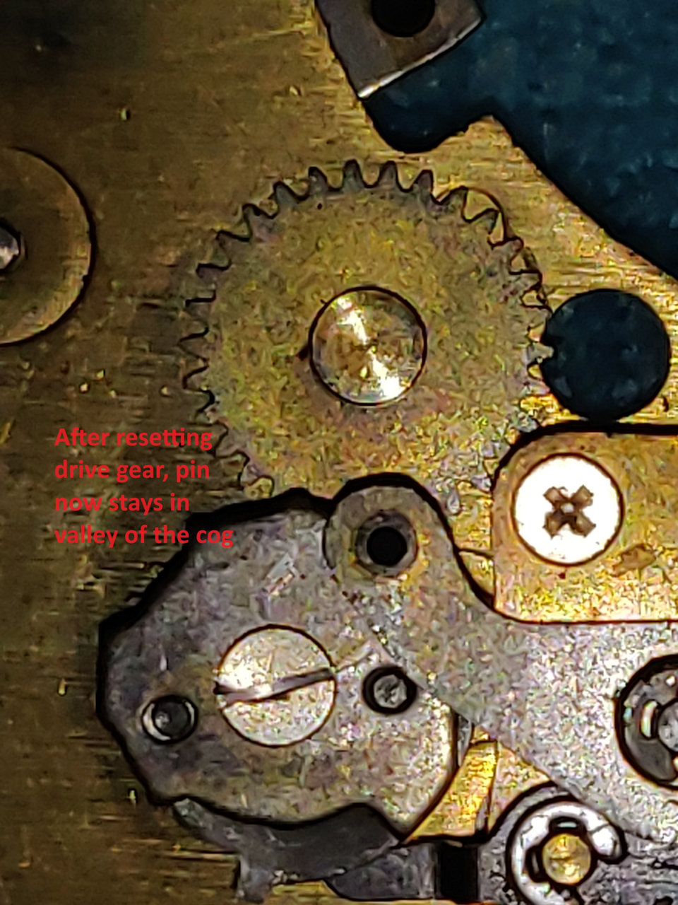

I believe I found my problem. The clockwork is fine. The gear that drives the speed setting was off a tooth. At the 1/125 speed setting, one of the cams that sets the speed was just starting to ramp to the 1/60 setting. Though not really on 1/60, the clockwork was slow for 1/125. Going from a slower speed to 1/125 would cause a problem, going from a faster speed to 1/125 would work fine. I reset the drive gear that sets the shutter speed and the shutter is now working fine. So I now have a usable 35RD

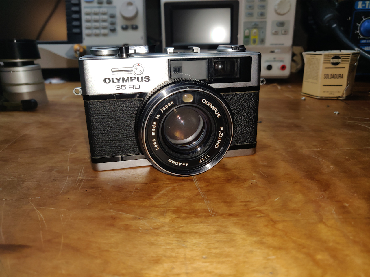

For this camera I decided not to do the battery mod and am just using hearing air batteries in a holder. I did some meter adjustments and buttoned the camera up. everything seems to work well.
With these old cameras I prefer to find them in good cosmetic condition but needing some mechanical work over working condition but beat up. The key point is finding them cheap vs a good condition camera that works for 2-3X the price.
This one was a successful find.
