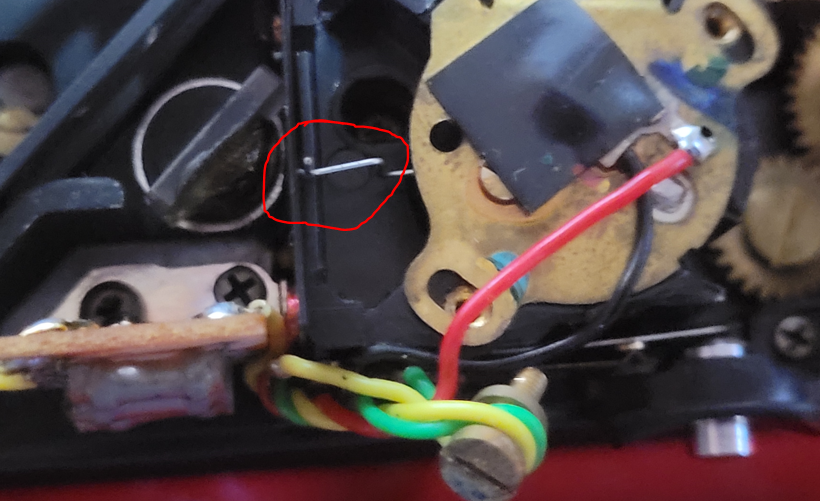

I came round an Olympus 35 SP. It's pretty (inasmuch one likes a brick's ergonomy), shutter is good, and the meter works...up until 9 EV.

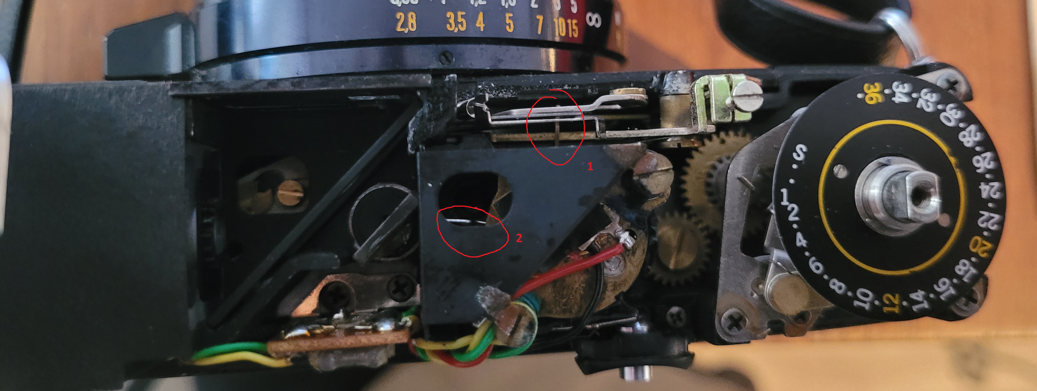

I think the problem is mechanical, as in: the needle of the galvanometer moves freely up until 9EV. from there it encounters some friction, seemingly, and do not progress further. I can gently push it onwards and I don't perceive any significant resistance, but it's as if it's touching on something in the mid section of the travel.
I can't say this second if the resistance is encountered by arm 1 or 2 of the contraption (pictured)
I did clean the parts I can get to with some alcohol without applying any serious friction, but the change is minimal, if any (I may be tricking myself in seeing the needle moving 1/3 stop more)

Thanks Ian. It is definitely possible, but I thought it could be mechanical as:
- it stops abruptly at 9ev without going any higher. It does respond differently in lower light (as in: it behaves as I'd expect it to)
- if I nudge it over physically, say, at 12: it stays there as if something is making contact. In the low-light area, it doesn't behave in the same way - it oscillates back to where it thinks it should be

Turns out I was lucky :smile:
"2" was touching the wall on the left during its excursion. at the max extension between EV 9 and 10. I suppose a bump could cause that. I removed the two screws keeping the thing (the galvanometer?) in place, adjusted its position ever so slightly, and now it works splendidly. Also the spot button works, it was nigh difficult to assess it in the dark before, but it activates nicely :smile:
