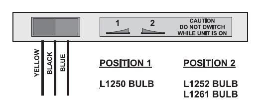

The "capacitor change" for changing lamp types is done via a rocker switch internal to the AL53 power supply. The switch positions are described in the AL53 wiring diagrams. See attached jpg. The wiring diagrams used to be available on OLEC's web site. The switch is located inside the front cover and should be visible through the grill above the power and configuration switches. You will have to remove the cover of the power supply to change the switches. Be careful not to touch or short the capacitor leads. The capacitors can deliver quite a jolt if discharged.
The 1261 lamp is broader spectrum than the 1250, but I haven't seen a significant difference in exposure times between them. I've used the L1250 in an AL19 and AL53, and an L1261 lamp in an AL53 unit. I have concerns about the potential damaging effect of the 1261 on skin versus the 1250 if you dodge/burn during exposure. But this is purely subjective personal experience.
