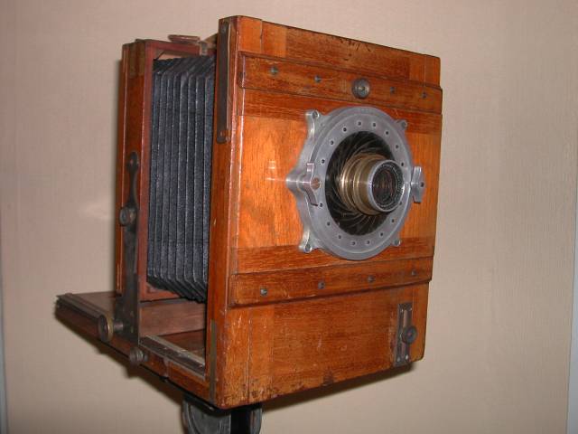

Here's a typical "good" 13x18cm Reisekamera. Note the continuous focus track. The iris mount is the reason I bought it, but when I had received it I decided it was to good to butcher. So I got another iris for the other camera...
Yes - gotta love those irises!
have one too, but they are SO expensive on Ebay......:sad:
