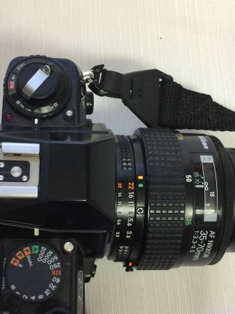

To add, this is what I am looking at:
Both lenses with aperture rings, it looks like ( I did not think of that until mentioned by poster above!).

There are cheap Nikkor AF 70-210mm 1:4, and AF 35-70mm 1:3.3-4.5 lenses, with a free N2020 near me.
Is this affordable glass worth using in my FM, FG, EM bodies, in manual mode??
Yes, they'll work just fine. I have the AF Nikkor 70-210 as well as a 35-135 and 28-85 that came in a bundle with an N8008 and N4004, and I use them with my FE and FG. They work fine. Biggest issue is the "gearing" on the focus ring -- there isn't much movement so it can be tricky to get precise focus.
They'll work on any Nikon with a meter coupling tab rather than a meter coupling pin (the thing that the rabbit ears engage). If it has a pin, you'll have to stop down the lens using the DOF preview button to meter. I believe that's the case with the F and F2.

Yup for the F. There are 6 eye level prism for the F2. One has no coupling whatsoever it's the DE-1. 3 with the pin, DP-1, DP-2 and DP-3 and 2 with the tab, DP-11 and DP-12.

The second version of the AF 35-70 (thick focus ring) has better manual focus ergonomics and feel than the first (thin ring).
This are the important things.
I do not use AF lenses, but to substitute manual focusing lenses, they should focus as good as manual-only lenses. Which means:
-) focusing ring at good position
-) apt damping
-) apt throw

The throw is shorter and not well damp. Both to make it AF better, less strain on the motor.

Exactly. Most af lenses have such a short manual focus throw that it makes it difficult to get precise focus.
