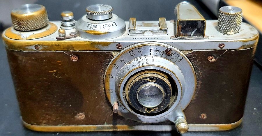

A friend of mine, camera collector and a professional photographer, had a rare treat for me: one of his father’s cameras, a Leica Standard. As per its serial, no. 207520, it was made in 1936. Although extensively used (and perhaps a little abused as well), the camera exhibits one of the most vintage looks. A treat, as said.
It is obvious that the camera does not work anymore; it could, but it’s my guess that in order to have this camera functional again, a good number of repairing hours would be needed, together with a good number of high denomination banknotes. I am almost tempted, to tell you the truth. Pity about the lens, which I suspect it was a Leitz Elmar 1:3.5 F=50mm. I very much doubt this lens here can be used anymore, looks too tarnished (and of course, incomplete).

It's amazing the amount of wear clearly from actual use! You can see just how he held it. Its owner must have rarely been without it. It's a pity the lens seems to have been torn apart brutally and the parts lost. Someone on l-c-f could probably advise on the possibility of replacing it.

Going by the serial number, I would suggest this is a Leica 1 made in 1926.

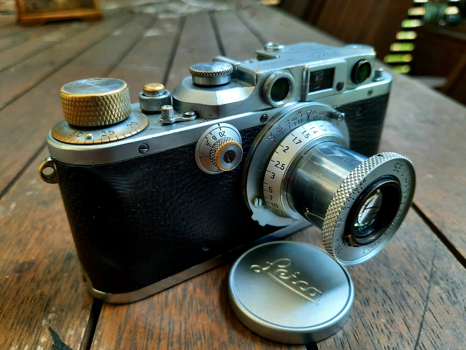

Beautiful camera.
I agree with Clive, much earlier than 1936.
This is my 1938 iiib, shutter button and rewind knob are heavily worn, optics are clean and all speeds are working, as is the camera. All cameras built so well deserve to work and be used.

207520 is definitely 1936, in the series 207401-207600. It looks older because it's been badly treated. I sold a Standard from 1934 that looked much better than this one, though not quite as well kept as Awty's. The lens doesn't help, of course: assuming that the mount isn't wrecked, any screwmount lens will fit this.
I don't think it would be difficult to get that camera working. No rangefinder, no slow speeds. The shutter curtain may need replacing but my bet is no other parts do.

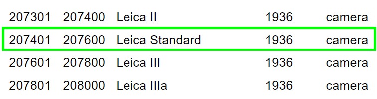

Thank you all, for your valuable input. My information regarding the year of manufacturing and model was taken from here, where the camera appears to be a Standard, made in 1936:

Cliveh offered a different link (thank you !) where the camera is mentioned to be different, although the same year of fabrication.
A bit confused now...

Where are these numbers from?

Minox, the compiler of Clive's list makes it clear (in a comment just above the green panels) that "I believe that this list presently combines a number of models into the "Leica 1" heading, including many Standard "C" models and non standard "C" models". So your camera is a Standard and not a Leica 1. The Leica camera and lens pocket book, 3rd edition, Hove Foto Books, 1986, gives a corrected list reproduced "by kind permission of Ernst Leitz Wetzlar". An obvious difference between the Standard and the Leica 1 is that the Standard's rewind knob is taller and extendable. Later versions of the 1, from 1949 onwards, did have that knob but not at the time your camera was made.
I agree that your lens is/was most likely a 5cm Elmar (not a Hektor, as that was a f2.5 lens). The two screws on its plate have been transposed, presumably when someone ruined the lens by trying to do a repair of some kind. It was a collapsible lens: you could try pulling it out, as what you see is the front element. The aperture has been removed.

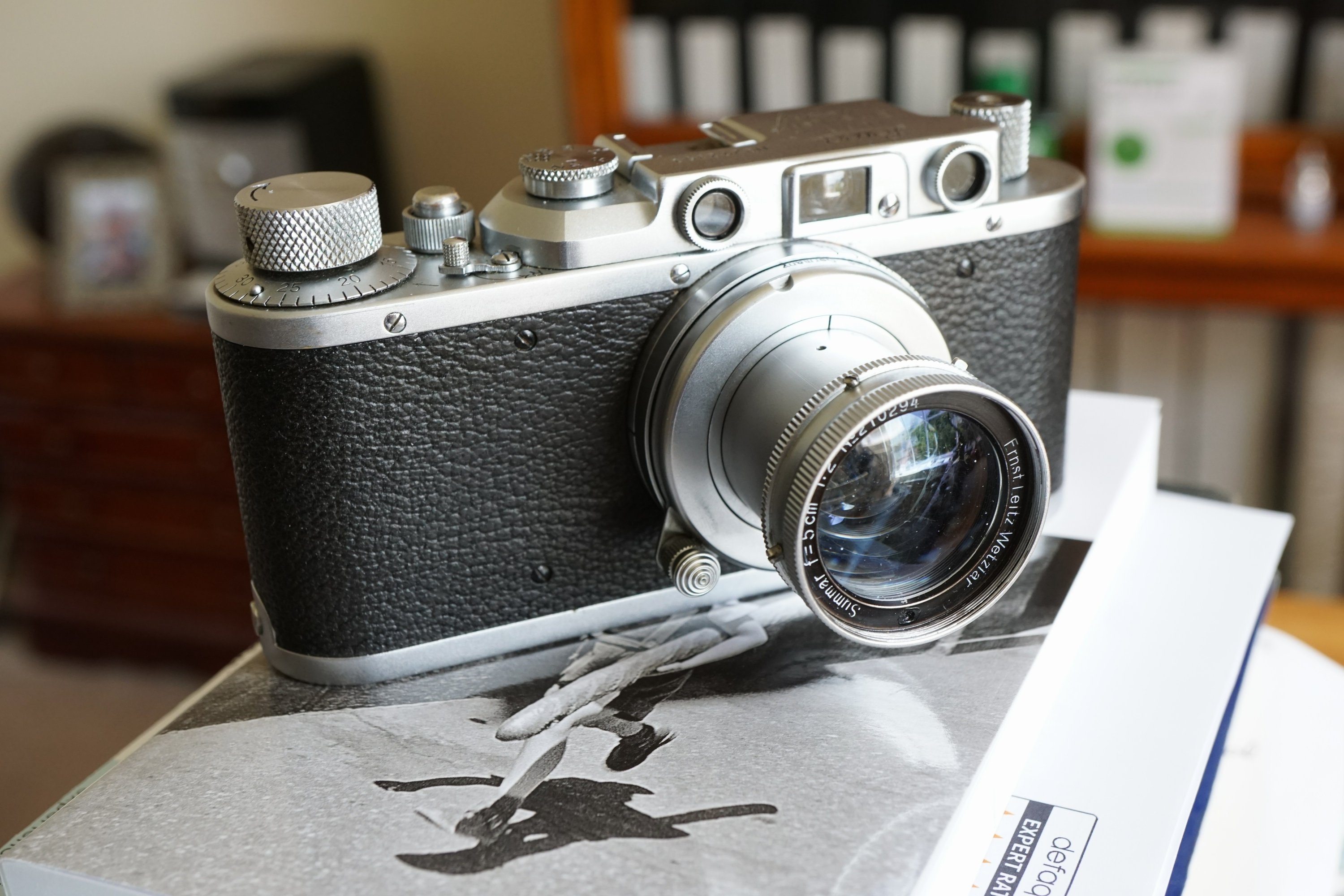

My Leica II from the the first batch made. Must feed it some film and walk it sometime.
I hope your conscience is holding you to that. That is one really lovely Leica II. Here's mine, which is rather later (1938) but with a 1934 Summar.
