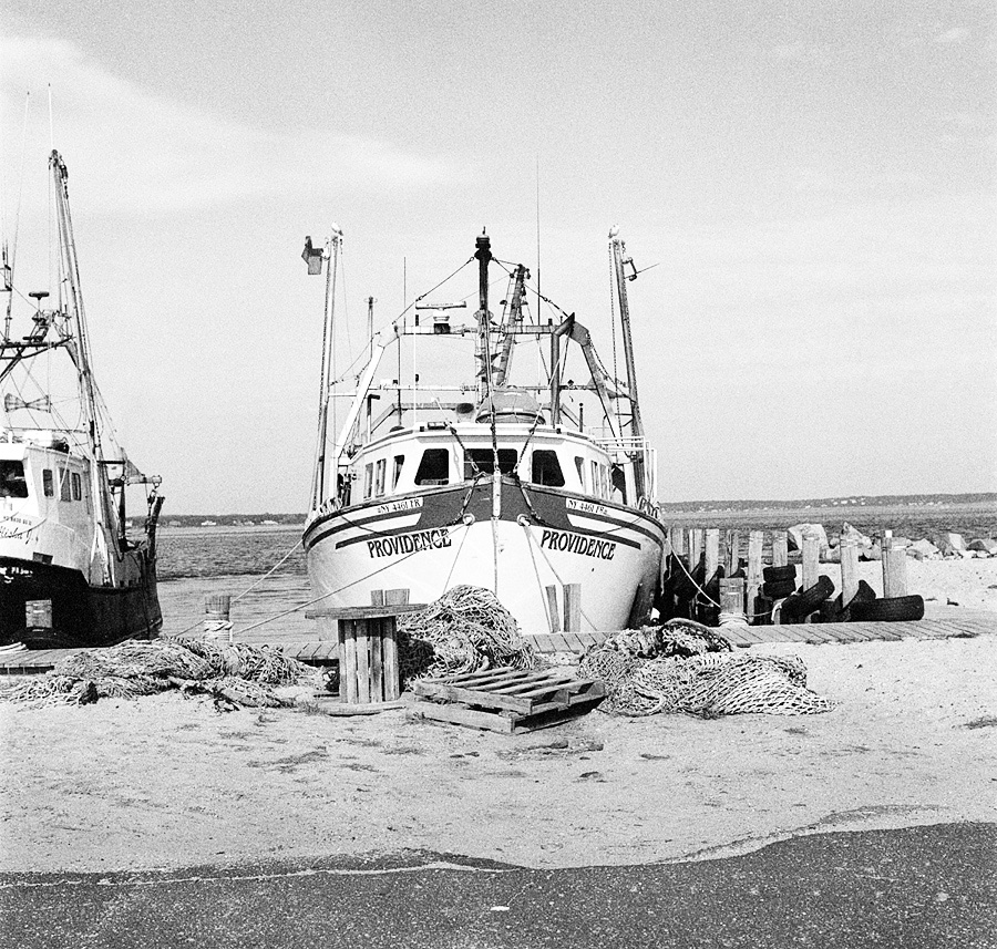

Hi,
I came across a roll of Verichrome Pan, it must be at least 30 years old. I had an old Bronica that I wanted to test for light leaks and gave it a try. I quickly found that there was little information about developer times/combinations with anything other than D76 on the web. I had Rodinal on hand. I tried it at 1:25, 8min @ 68F. It was about 1 minute to much and the film showed signs of it's age, some fogging. Verichrome Pan was never my film of choice, I preferred PXP for it's tonal range. But Verichrome Pan had finer grain and a very wide latitude. it's the film that was produced for the 620, 127, and Instamatic cameras that used a fixed 1/125 @ f8. I don't think it was ever produced in 35mm. If you find some give it a try.
I think the over-development and Rodinal increased the grain, next time it will be D-76.

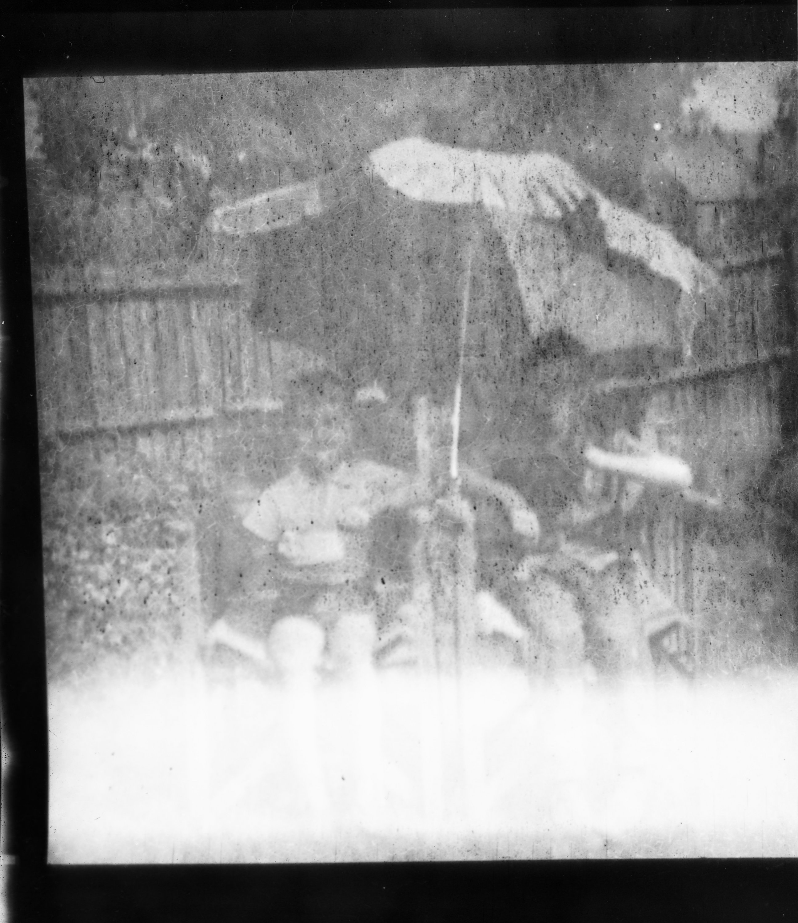

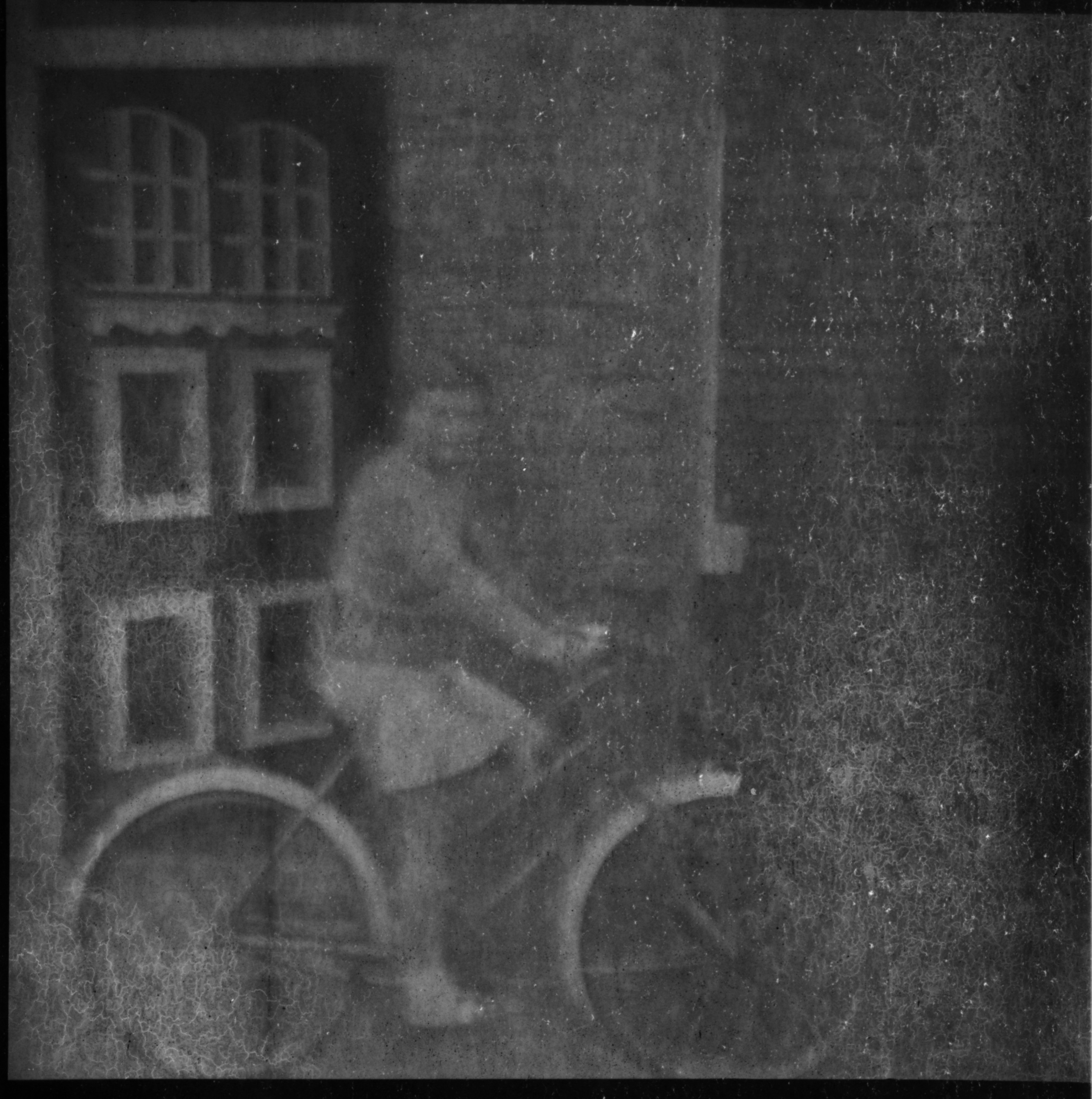

Here are my two found images .. I suspect that they were actually shot out of focus .. and that may be why the film was not developed int he first place ..
So you knew that the photographs were out of focus before you developed the film ... :wondering: well evidently you never have instant photographs.
Not quite sure I understand this .. This film was exposed 5 years before I was born .. I found it in someones studio .. the fact that the whole roll is out of focus might suggest why the roll was left for so long ..
