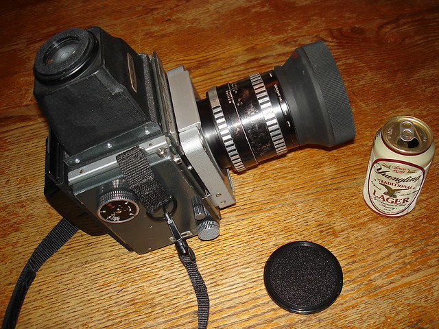

Hey Stephe,
I'm fine, just retired Dec 31st, so lots of time for photography. Renovating my darkroom for B&W and building sink and stuff. In no particular hurry, I'm only 60!
2016-01-01 14.22.12 by Nokton48, on Flickr
You will get a kick out of this. Sold all my Kiev, Hartblei, hot rodded Pentacon, EX66 etc. Still have a small box of stuff left. I hacked this Zebra 180mm to fit my Plaubel Makiflexes. I have three of them, like a European focal plane shutter RB67. I have hacked dozens of lenses to fit the 'flexes. It's a hoot. These are not as heavy as they look. 9x9cm image on 4x5/9x12, or 6.5cmx9, or 6x6, on 120. 9x9cm has amazing fidelity!
Building stuff just like in the old days :smile:
Still have my Hasselblads.
