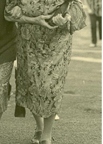

I obtained some paper but i am not sure about its age/brand/previous history
I tried a few enlargements and they come out tinged slightly brown where it should be white.
I am not sure if this is becuase the paper is old (?) or maybe I am not fixing it long enough?
I have the same size paper (8x10) in gloss from ilford and it is perfect with the same fixing time.
So my question is, do other types of paper require specifically longer fixing times, or is this a consequence of the age of the paper.
Thankyou.
and example is below
Definitely it's the age of paper. In the enclosure a sample of a 50 yrs old paper.
It's the "vintage" effect.....

Is the paper a fiber based paper or a RC paper? It looks more likely that either the paper is fogged (fairly likely), losing contrast (highly likely) and possibly warm-toned as opposed to cool toned paper (possible). What developer are you using? Using a warm-tone developer with a warm-tone FB paper has a much different tone than using a neutral developer with a RC paper. My money is that the paper fogged; the edge markings are the best clue to my eyes, especially the-none image edges of the print being the colour they are. It almost looks lith-printed; how long an exposure from what approximate enlarger height? Also, how long in your developer and how old is your developer? I had some old Dektol I tried using (very black, like coffee) and it stained my paper like old tea.
PS faustotesta is also right about old paper just giving a different old look than new paper
i think it is fiber based. The developer was ilford multigrade (thats all it says on the bottle) I have no idea about the type of paper being warm or cool toned, it came into my possesion with only a black plastic wrapper. I will try letting it fix for long period of time and see if i can exclude this variable.

I agree with faustotesta. I keep all the old paper I can get my hands on. Most of the time it is not the look I want. However with some negatives I get the my BEST prints on old paper that shows it's age. When you consider that "expired" can often be gotten for free or close to it I don't know why more people don't play with it.

Something similar looking happens if you don't fix the print well enough, then leave it out in the light for a while. It happens, but you'd pratically have to not fix it at all, and it doesn't happen immediately. This example looks more like bad paper, and it's a mistake to think that you can finely tune your process with this stuff. You can work out all the procedural difficulties you may be having, but you won't be able to learn how to fine-tune a print with it.
