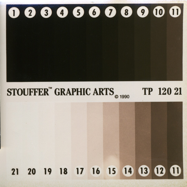

All all this talk of printing on old paper and no one has shown anything. I do what I can here. These scans aren't quite as nice as the original. I only retouched brightness after scanning.
Ok here it goes first contact sheet of a step guide
All prints are developed in Defender 58D 1:1
If people are interested I will post times for exposure. Development was 4-6 minutes. Exposure 90 to 270 seconds. The Opal was in an enlarger everything else contact.
Order of paper Opal 1949, Illingworth ?, Velox 1954, Azo 1931
I will post some more pictures later.

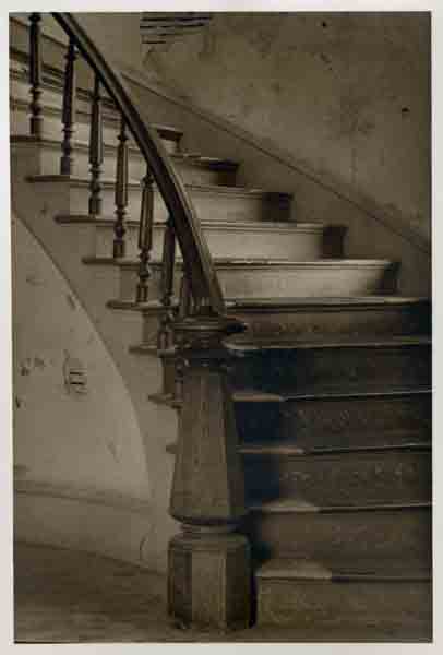

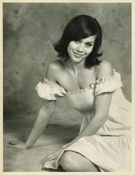

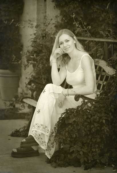

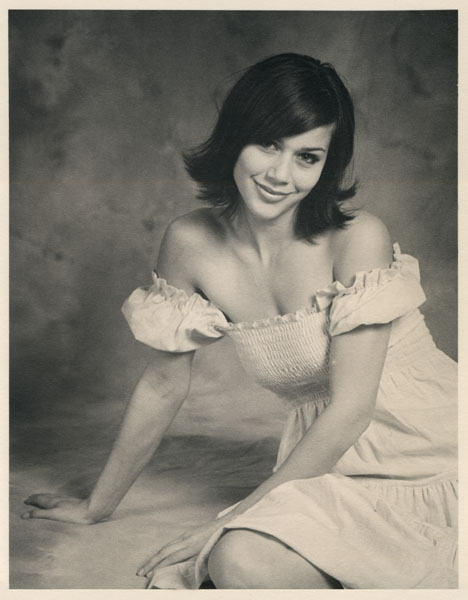

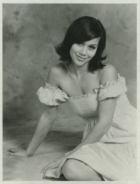

Here are some pictures
1. Azo 1931
2. Luminos 1974 (I think the date is accurate)
3. Opal1949 - Scan seems to have more color then the original. All Brown in
my print.
4. Velox 1947
5. Opal1947
6. Velox 1954
7. Velox 1974
I have to size a number of scan of other papers. When I get a chance I will. Those will be of the same negative on different paper.

..very nice and interesting! Thanks a bunch for posting!
Best,
Cor
sun of sand
Feb 8, 2007
601

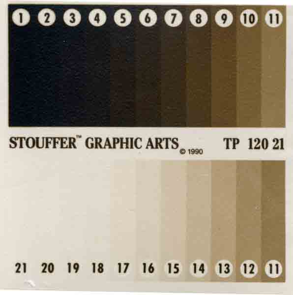

I like the Opal. That looks fantastic! I have a little 70's. Box sold for pennies couple weeks ago that must have been from the 40's.
Neat stuff.
How do you read the tablet? What kind of info does it give?
Illingworth looks the worst?
Opal looks smoother than Velox and less biting ..a better portrait paper?
Why does the Azo seem to have so little in the blacks? More in the midtones? Most contrast? Very subtle gradation.
The velox/azo scans don't seem to match in color to their tablets.
Velox came out olive/sepia and cold. Opal matches in both. Azo is completely opposite.
I wouldn't hesitate to use any of that paper ..even with the difficulties. The Opal is more my style, though.
don'tcarefortheLuminous.
"...same negative on different paper" Great
Any antifoggant added? Which one took the 5 minute exposure? I have some 70's Polylure that is fogged a bit but with 4 minutes at
f5.6 -contact print- it comes out fine. Must have been stored in the oven. I thought Polylure would have been a close cousin to Ektalure but on one of the sites dealing with old paper it was classed a SLOWER chlorobromide than Ektalure. I've seen a lot of conflicting classification. Read it's variable contrast from grades 2-3.5, or something, too.

Oops the the file names are correct in the step wedge area. My understanding of the step wedge is limited. I believe this one is in 1/2 stop increments and 11 is zone 5. Someone more familiar with this wedge would be better choice for explanation. I used it to show the range of the paper. Of the 4 shown the Illingsworth's range goes across the whole wedge. Quite impressive really. It did have the most fog, I don't know if this had anything to do with it.
My goal was to have the range in the middle assuming that it could be moved up or down the scale.
The 4 wedges were all processed in 58D the color is the combination of paper and developer. Al were Selenium toned. the prints are form different developers. The brownish tone ones are 58D and the Olive or black tone ones are LPD 1:5 with 50ml of Benzotriazole per 1000ml added. The LPD works well with contact paper not to good with enlarging paper
I would be interested to see other old papers from this group if anybody has some.

The photo of the lady sitting on the bench, Velox 1954, certainly has that "3D effect"....at least on my monitor it does.

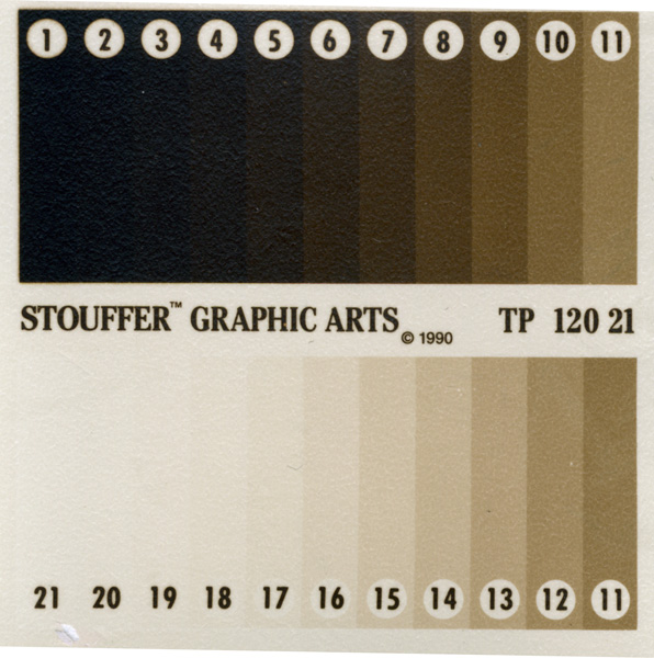

Here is a new scan of the step wedges from the opening post. They more reflect the tone of the originals.
All were develored in 58D except for Illingsworth witch was LPD 1:3 50ml of 1% sol. Benzotriazole.

Well, I'll give a guess here that we are looking at Opal, Velox and Azo as being a halide and/or addenda series that shifts from brown, to purpule to yellowish (on my monitor), and without the toner, these variations would be very very subdued and maybe even reversed in order.

Photo Engineer
Apr 19, 2005
29,018
Rochester, NY
Ok, Opal is an enlarging paper made from a Silver Chloro-Bromide emulsion, probably high bromide, Velox is a Chloro-Bromide with high chloride, I would guess, and Azo is a pure Chloride emulsion for contact printing. The first two in the early days, contained Cadmium and/or Mercury salts to control curve shape and tone. Azo used another method.

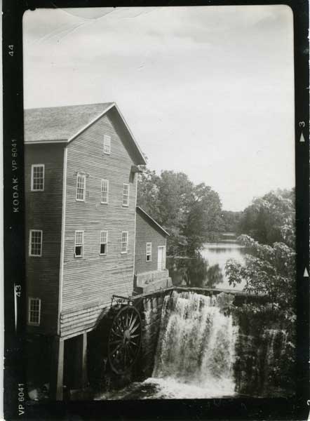

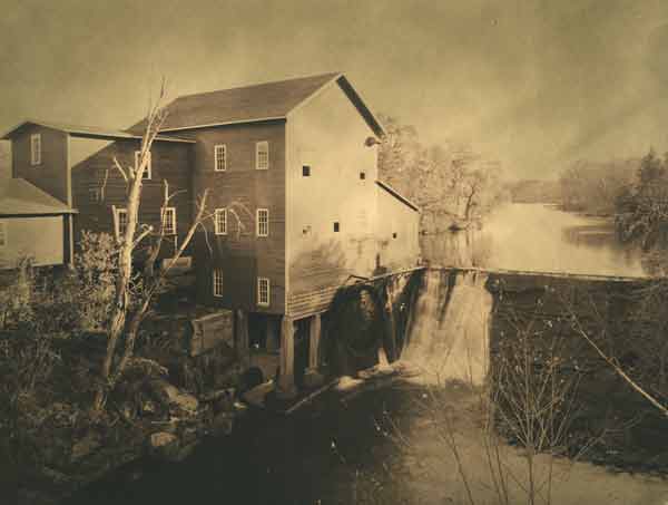

Here are some prints printed on the same paper. All enlarging Defender 58D. Nothing scientific here just shows a print can be made on old paper.

jgjbowen
Oct 13, 2003
879
Richmond, VA
Robert,
Are all of these on the same paper grade? I ask because the cykora portrait seems to have much more contrast than the portrait proof.
Thanks for the images.
Jan 21, 2003
15,708
Switzerland
Randy, thanks for sharing these results. I have actually seen all of these in real life, and the variations in surface texture was quite tangible. What really struck me was how fog free these older papers printed.
Randy has been very kind in mixing me a couple of batches of the 58-D formula that I intent to try on some really old Velox (I've got 700+ sheets that expired in 1947) and some Agfa Portriga Rapid G2 and 3 from the 1980s that fog very badly in Ansco-130 glycin developer (although it works with lith chemistry, and beautifully so).
Another highlight is how beautiful some of those old papers are. Man, I live in the wrong decade. Although printers back then would probably be excited about some of the papers available to me... That whole thing with grass and how it's greener on the other side... Whatever enables us to make nice prints like these is definitely worthwhile.
Thanks for sharing your results, Randy!
- Thomas
