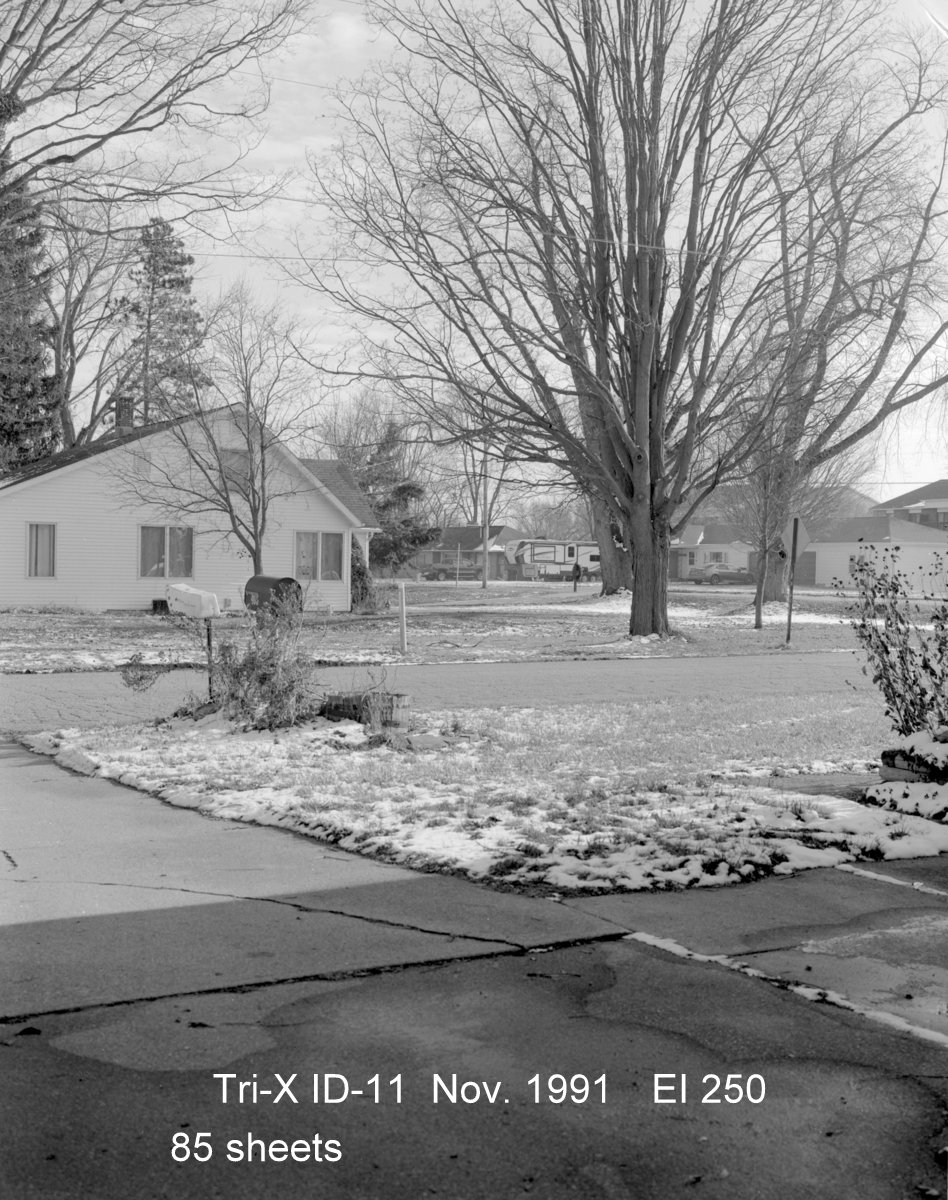

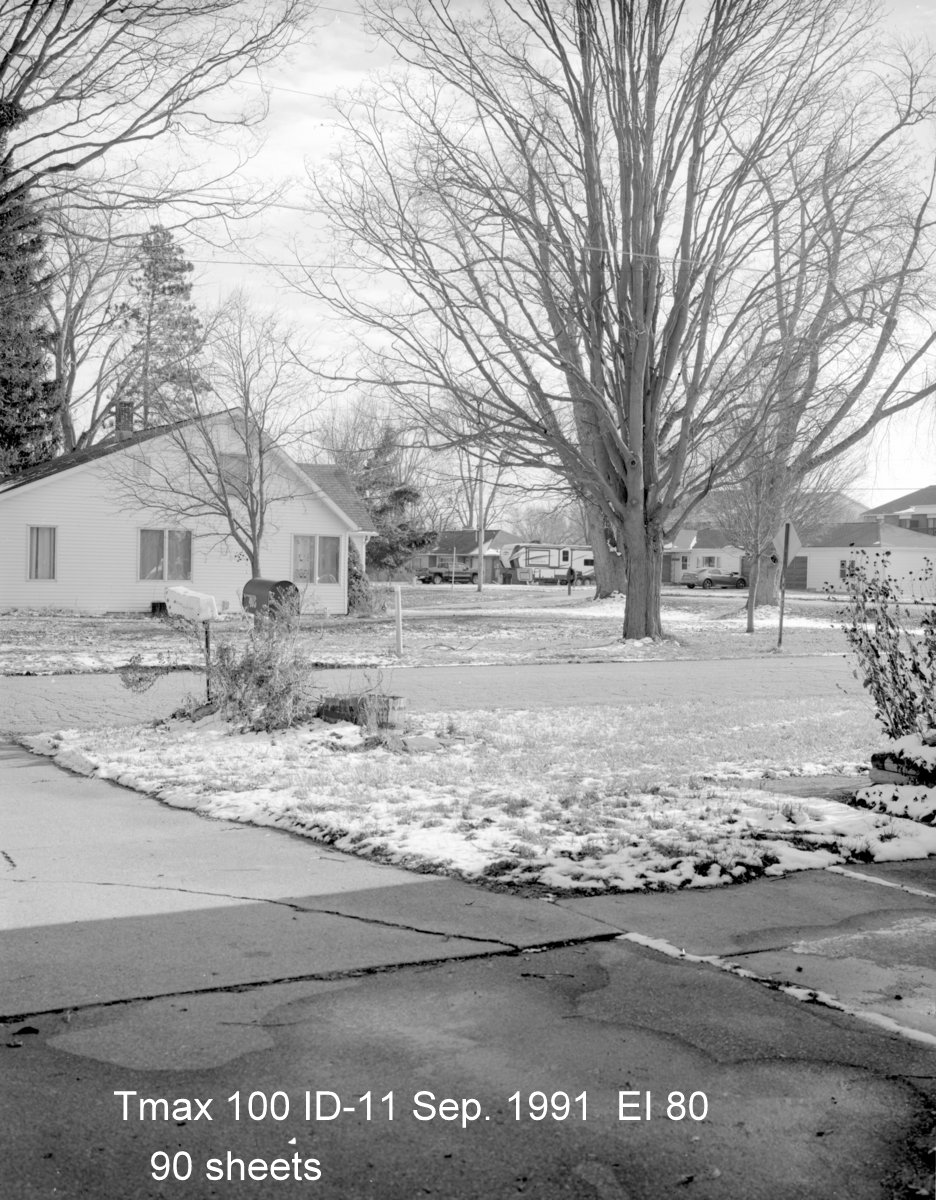

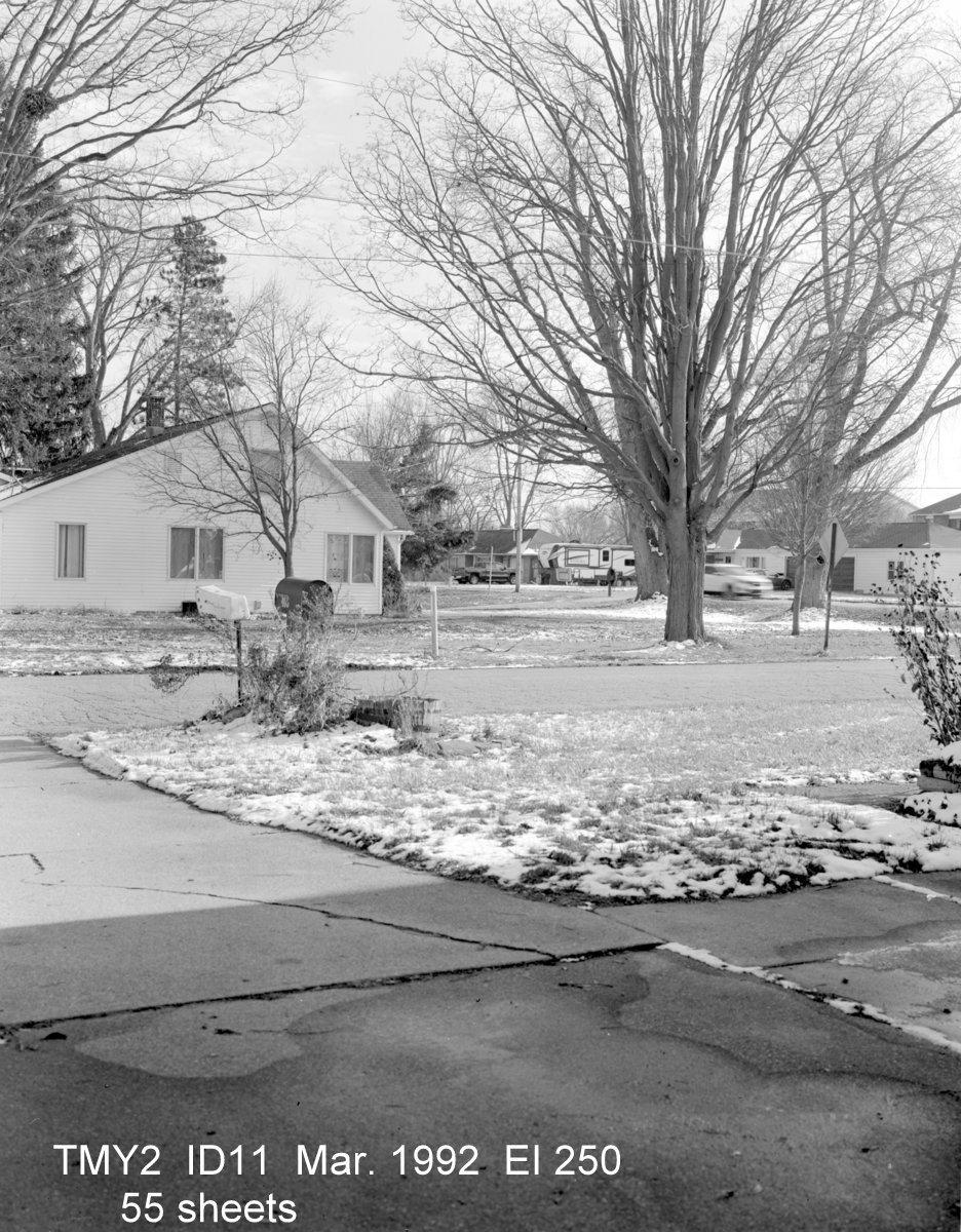

I've read countless posts on the topic of outdated film, but never really messed with outdated film myself. I mean really outdated, and not just a year or so outdated. The story begins in Chicago at a Camera collectors show where I was set up. A fellow came to my table with a stack of outdated sheet film in 4X5 and 8X10, both B&W and Fuji transparency film. He asked me if I'd be interested in buying all of it. I ask him if it was all good and properly stored. He said it was kept at room temps and never got over 75F. I told him I couldn't give him much since I couldn't try it out first. He wanted me to make an offer, and I just told him to tell me what was the absolute rock-bottom price he would take. Well, I ended up with a pile of film dirt cheap. That was in about 1994-95. Fast-forward to now. Well it's been in the bottom of my freezer ever since and even went through one freezer breakdown/thaw out to boot. My wife and I are preparing to move to or cottage full time, so it was time to start cleaning the old house out. I dug the film out and thought I'd see just how bad it was, or if it was even useable at all. So I loaded some 4X5 holders with TMY2 dated 03/1992, TMX 100 Dated 09/1991, Tri-X dated 11/1991 and Plus-X dated 1/1992. I used a little Fuji 150mm f5.6 (single coated) lens and my LunaPro light meter in incident mode. I rated the 100 ISO film at 80 and the 320 and 400 speed films at 250. The results really surprised me in a very good way. There is a tad bit of base fog, but not as bad as I thought. Also, there were no emulsion defects like molting or mildew. I hope the 8X10 film is as good. I haven't even tested half of what I bought, so I'm keeping my fingers crossed. Here are some straight scans out of Vuescan and an old Epson 3200 flatbed scanner.

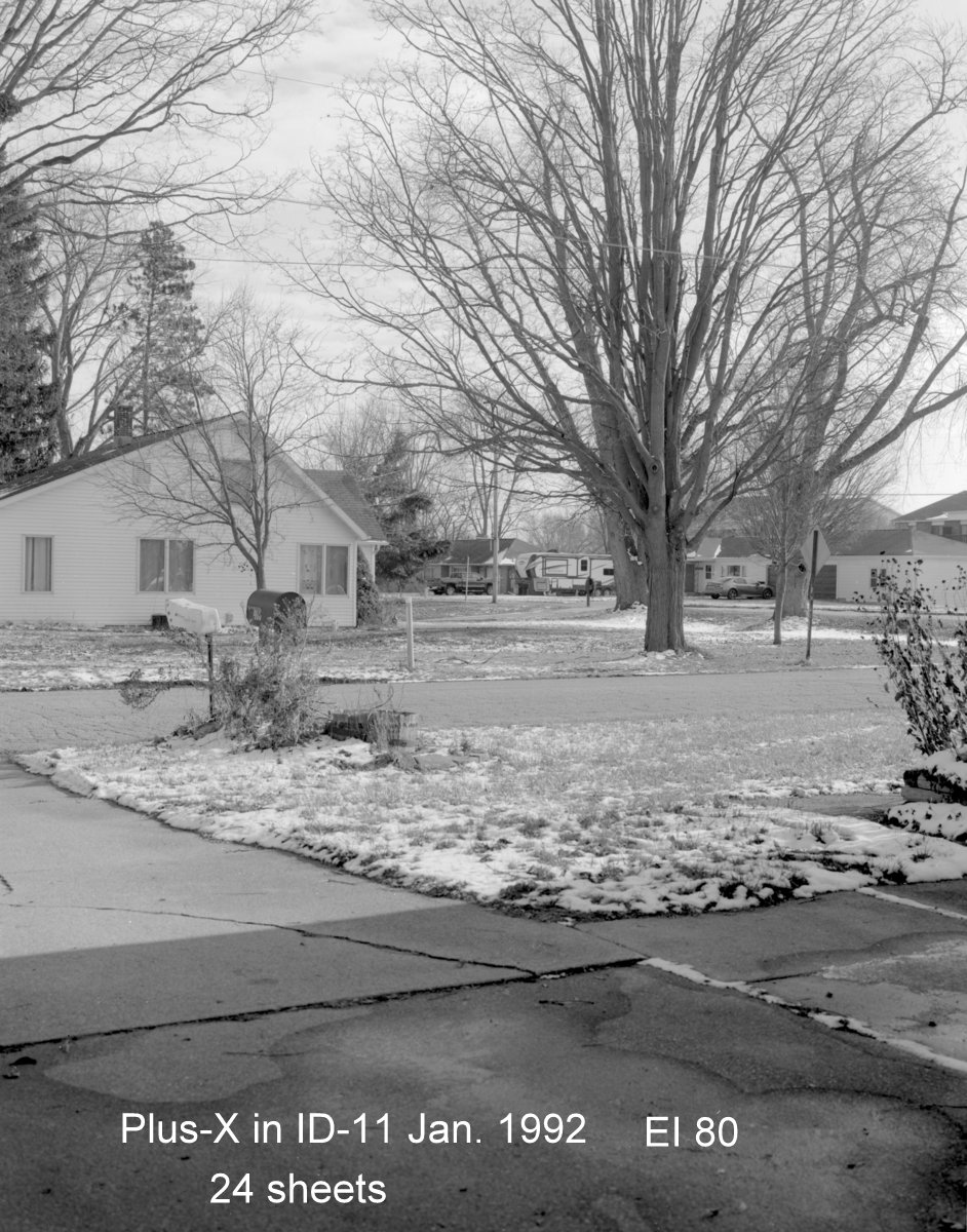

Nice! I had the opposite experience this week-- a box of very old 4x5 Panatomic X was, finally, too damn old (the date had broken off the box, but the old-style labeling probably indicated 1957 or so). It was an open box when I got it, so my rule of thumb of "Pan X in a sealed box from 1963 or newer is plenty usable" is stretched but not broken.
I also found a box of Kodak Royal Pan from 1958, but it didn't come from the guy in Chicago. In fact, I have no idea where it came from, but I'm pretty sure it's toast. What really surprised me with this test was that the TMY2 and Tri-X were no more fogged than the 100 speed films. I've always heard that HC-110 was the developer for old, outdated film, but ID-11 1+1 seemed to do pretty good for me. I'll be trying Pyrocat-HDC or Wimberley's wd2h+ next and will post the outcome from that. One last note, the actual scans from the old Epson are much sharper than what ended up here. Don't know why other than the downsizing?

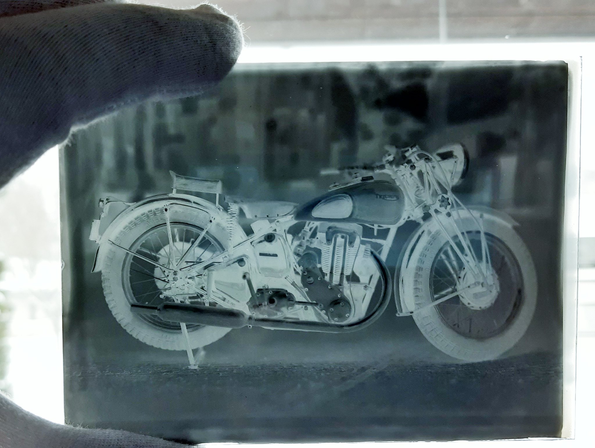

In my books your catch is fairly modern! I've been using (slowly!) a bunch of 23 boxes of glass plates from 1940's and even earlier. Some of the stuff only has very slight silver mirroring on the edges. All of the Ilford plates have been good, haven't tried Kodak yet. Sensitivity is much reduced, like from 200ASA to 25. I've had good results with powerful developers like Ilford ID-33, (may even try some day paper developer, if lazy). Some more in Flickr: glass plates
In my books your catch is fairly modern! I've been using (slowly!) a bunch of 23 boxes of glass plates from 1940's and even earlier. Some of the stuff only has very slight silver mirroring on the edges. All of the Ilford plates have been good, haven't tried Kodak yet. Sensitivity is much reduced, like from 200ASA to 25. I've had good results with powerful developers like Ilford ID-33, (may even try some day paper developer, if lazy). Some more in Flickr: glass platesView attachment 357742
