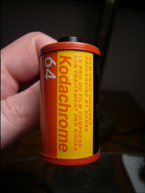

Kodachrome used to come with an envelope that you could use to mail the roll back to Kodak for processing, but it was simply for your convenience. The indicator of processing included was the red ends on the cannister, and it said processing was included.
Since this is Canadian K25, it will be processing included. It's only been in the last two years or so that you could buy Kodachrome that wasn't processing included in Canada.
Hopefully this film will be ok, but I have my doubts. I had some old film that I was given, and supposedly stored cold, but it went magenta and had a significant loss of D Max. Some rolls were ok, others were very bad. Do a test roll, but don't use it on anything critical until you get the first roll processed. Attached is an example of the color shift.

I just don't know whether to ship to the Kodak address as indicated on the box, or to send it directly to Dwayne's. I'll put a call through to Dwayne's after our (Canadian) long weekend.
I've always dropped off my Kodachrome at London Drugs (alas only in Western Canada, excellent E6 and dirt cheap) and they ship it off to Dwaynes and LD charges me $1.25 (inc tax) handling fee. I think that's probably cheaper than postage to mail it to Kodak. Comes back in about 3 weeks, and I've never had a problem with them honouring the pre paid processing.
Hi Craig,
Your earlier post and pic says it all - red/orange end caps and "processing included" on the canister. Does anyone remember if the processing included super 8 had any markings or label saying that? As I recall it didn't, but the lab could tell by the film or cartridge. Of course the box said so, and the mailing envelope required one to put the proper address (selected from a list) of the receiving point for the country from which it was mailed. It is only of academic interest for me now.
Also, do you know if LD still handles Kodacrhome? Since I live in the NWT, I either used the mailers, for $1.85, or dropped (for free) at Shoppers in Wpg. where I have family. I now have fresh (non processing included) KR64 and PKR64, and am comparing the costs of shipping directly to Dwayne's vs drop off when I am in Edmonton, Calgary or Wpg. For 5-10 rolls direct shipping seems like the best deal, but for a single roll, shipping to the US and back becomes very dear.
Further to "old, old film", I don't consider 1998 Kodachrome 25 to be that old, but it also seems to be the case that most sellers of past date film claim that it has been stored in liquid nitrogen since purchased. A test roll or two is always a good idea. Now, if I only had some - sigh.
