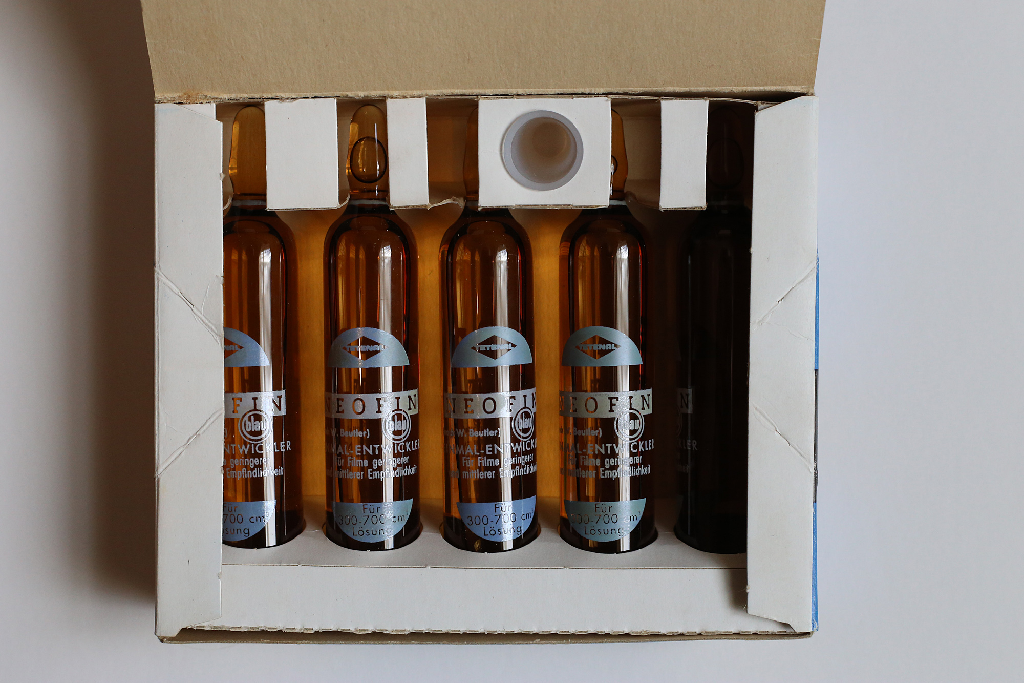

I bought some phials of Neofin Blue estimated by the seller to be about 30 years old. This is not verified as I don't know when packaging was changed from phials to the present small bottles.

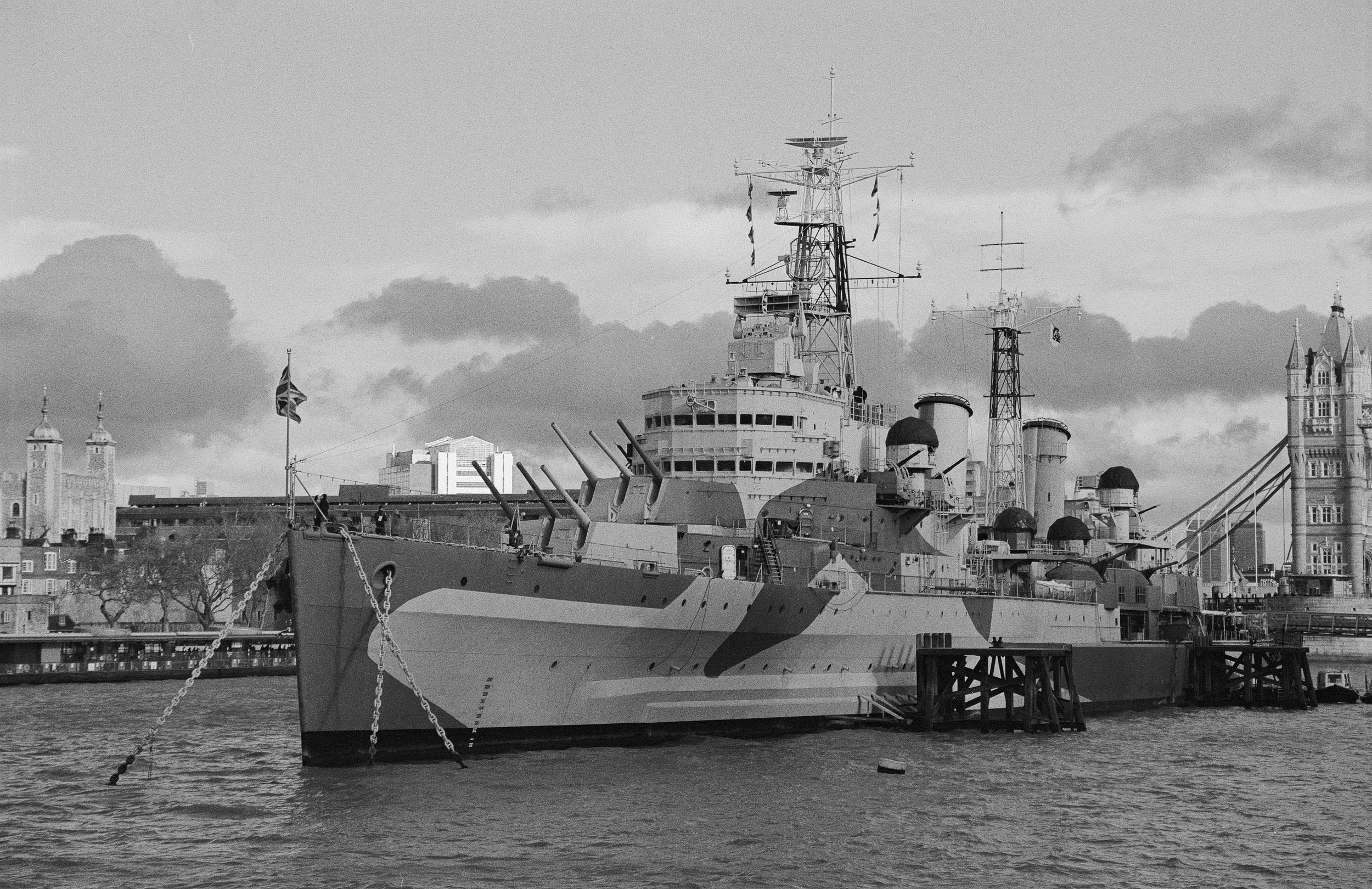

Agfaphoto APX 100 at EI=100 was developed for 14 min 20C (as per massive development chart) in a phial of Neofin Blue diluted to 500ml (faint straw color, pH>12).
The density of the negatives obtained (see pic) was normal, in fact it looks the same as APX 100 developed in a newer bottle of Neofin.
So these phials have a long shelf life.

The developer in sealed glass vials should have a very long life since oxygen cannot get to it. However newer packaging in plastic bottles has a limited life.

Thanks Pentaxuser,
Yes it is the Belfast with Tower Bridge just visible in the background, the area near London Bridge Station is a happy hunting ground for photography.It was taken 2 days ago using a yellow filter.APX 100 works well with Neofin Blue.

The last time I purchased many years ago Neofin was in plastic bottles with a plastic cap. Glad to see that they have switched to glass. However the plastic cap is now the weak link.

Thanks for posting pics---it brought back strong memories of when I used lots of the solid glass vials w/Panatomic X.
