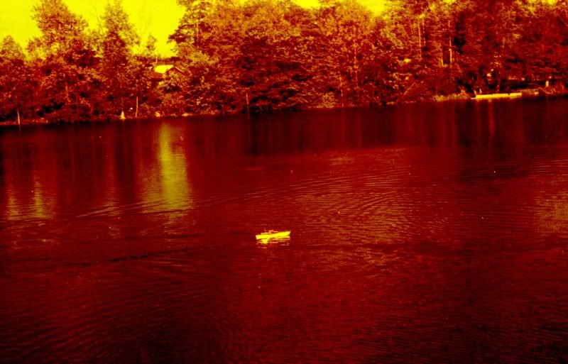

I actually tried scanning them, and the blue channel is almost completely gone, the green is limited but useful and the red looks just about complete, which gives them a severe colour cast, kinda like this one:
Note the lovely yellow sky...

Does your scanner have Digital ROC (part of the ICE package, some Nikon scanners have it and I think some Minoltas too). I have used that function on my Nikon 8000 a few times and it has done wonders for films like yours.
Unfortunately not, fortunately though, I like B&W images:D, and if I am careful with the channel mixer, I can get something acceptable.
Images like the one posted, I don't really care about, the photos I really hate to lose, are ones of my father, who passed on the same year..... Fortunately at the time, the majority of my work was B&W, and most of those are as good today, as when they first came out of the soup.....
