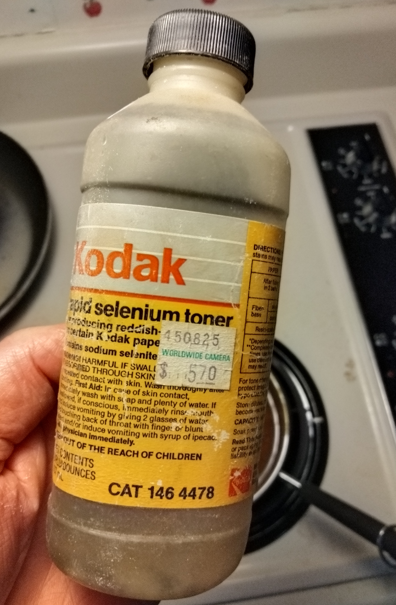

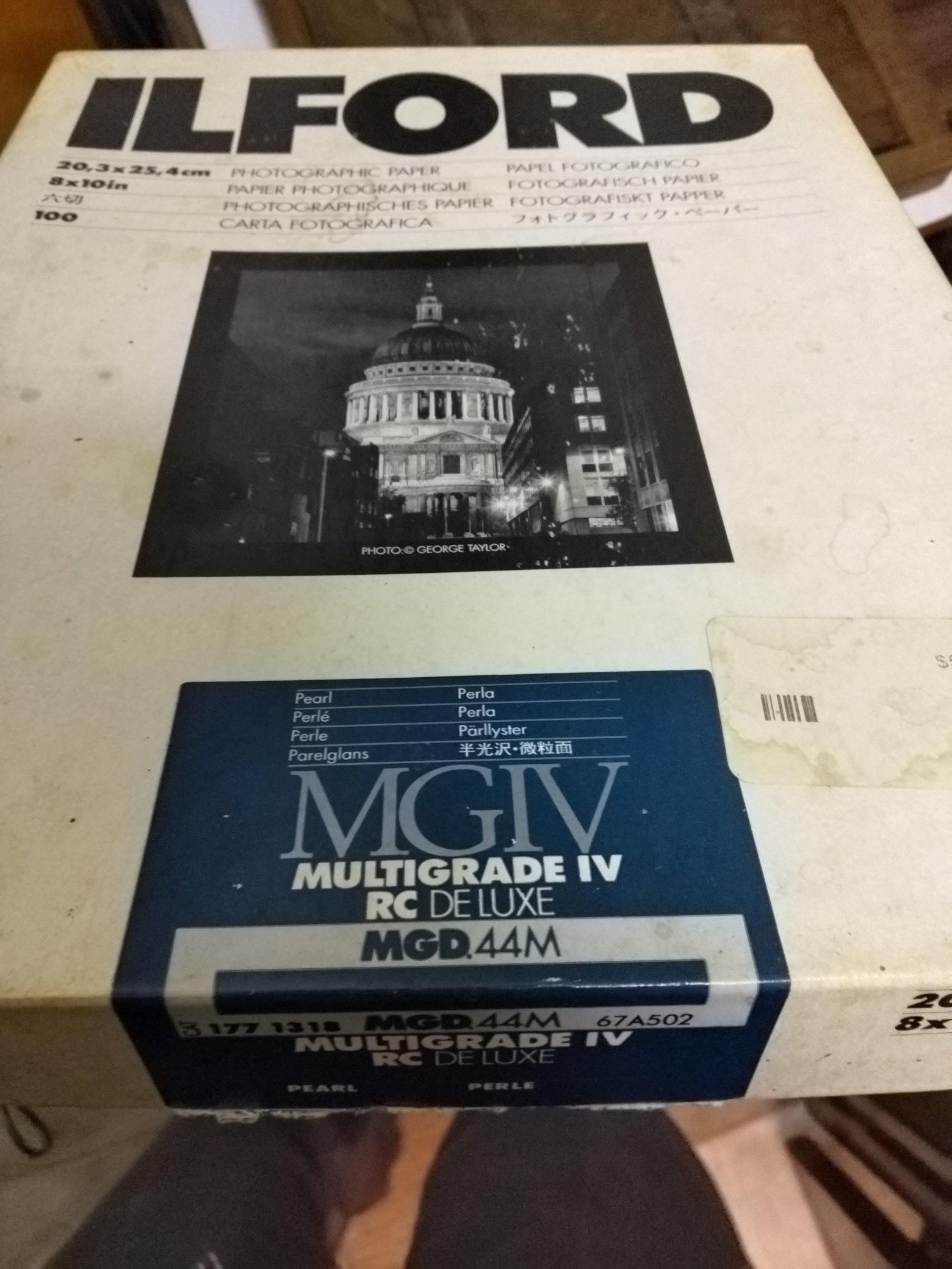

At this advanced age in life, I find myself having set up quite a nice little darkroom in a mostly unused bathroom. Better darkroom that I ever had. Anyway, I've pulled out a lot of old things I've had for many years. Some since the 70's. Chemicals, paper, equipment, and I'm pleased with the percentage of various stuff still proves adequate to get going till I order new supplies. But lets get to the question. I dug up these 2 unopened bottles of KRST. I mixed up some, first at 1:10, and it did nothing. I mean nothing at all. So I upped it to 1:5. Still nothing, after 1-2 hours of a test print dunked in it. But I also remember back in the day, some papers would not selenium tone no matter what. Seems like they were always RC papers. So, I'm posting my question with a photo of both. Is it the old paper, the old toner, or both? FWIW, My sense of smell is shot, but I swear I sense the slight smell of ammonia, which is a familiar smell from my young days for selenium toner. Thank you.

llford Multigrade IV paper was designed to give extremely consistent results when used in a wide variety of circumstances, employing a wide variety of developers.
One of the consequences of those design goals was that the paper is relatively resistant to toning, and particularly resistant to selenium toning.
In addition, Multigrade IV could be quite old, and that selenium toner is very, very old, and the combination of old paper with very, very old selenium toner may very well reduce the response.
Just a reminder: selenium toner requires careful handling. Dried selenium toner residue is very bad for you if inhaled.
Does the paper say Harman Technology in the small print on the back label, or does it say Ilford Imaging?
If it says Ilford Imaging, it definitely is old.

I've used old Kodak selenium toner, no trouble. As Matt said, Ilford MGIV doesn't respond much to Selenium. I use KRST 1+3, it gives a slight increase in D-max with cold tone papers. I dilute it for warm tone papers, warm tone paper responds dramatically to toners.

It's Ilford
Ilford Imaging labelling means before the receivership in 2005 - but it could be much older than that.
The current Ilford RC paper - often referred to as Multigrade V, but not actually labelled as such, is apparently intentionally engineered to be more responsive to toning than Multigrade IV RC.
With stronger (and fresher?) selenium toner, the Multigrade IV eventually responds, but you may not be happy with the resulting image tone.

The easiest way to verify the correct working of the toner is to use it with a paper that tones readily. Something like Fomatone. Lacking that, you could take any kind of paper and develop it only halfway so that it yields a very warm-toned image to begin with. Then test the toner on it to see if it has any effect. By severely underdeveloping the paper, you end up with a much smaller silver particle size that's far more susceptible to toning, and that will also show a color shift much more readily.
Given the age of that bottle of toner, I'd not be surprised if it turned out to be dead. The black residue caked to the inside of the bottle (note the shadows) is probably the selenium that has deposited on the walls of the bottle.

Contrary of what's being told, all kind of chemistry expires with age.
KRST is no different. I'd suggest to buy another fresh KRST bottle if needed.
