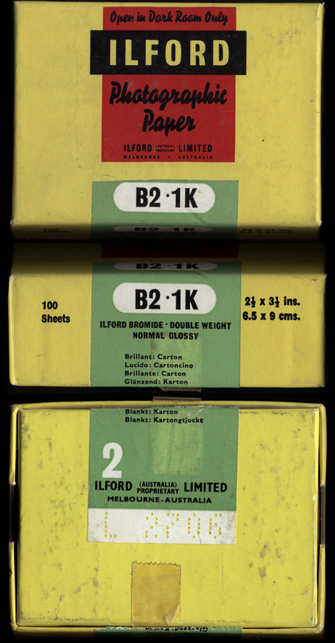

If we're guessing how old various papers are, any ideas on this one?:
The batch number is L2706
I printed to it a couple of days ago and it looks perfect to me. Cute little 2.5 x 3.5 inch prints that remind me of my grandparents' photo albums.
I also printed some Ilford Multigrade III RC Deluxe Glossy last night with no problems. The previous owner hadn't opened it but was kind enough to write on it that they'd purchased it in May of 1994... Seventeen and a half years later and it's still going strong!
