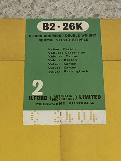

Hi all.
After finishing the new darkroom build, I'm finally going through some old paper that was gifted to me and found a couple of oldies that caught my eye.
They are marked Ilford, but on the reverse, it shows "Ilford (Australia) Proprietary Limited", so I'm guessing both packets are pretty darn old. One is Bromide B2.26K and the other is Multigrade MG.26K and both are double weight, velvet stipple.
Any idea how old this stuff is and more importantly, has anyone used this stuff and if so, how and what kind of results did you get?

I recall a photoshop in Melbourne (where I purchased my first enlarger) selling me on the beauty of velvet stipple, that would have been in the late 70's but the packets in your pics look older than that, the packets of velvet stipple I got in the late 70's were the familiar white Ilford packets so I would guess they are early 70's. IMO, life is too short to be messing around with way out of date paper.

I've been digging around in my notes and have found leaflets from paper made in England from the (marginally) earlier, yellow packaged paper with the three dimensional lettering. It's dated 1949. My Multigrade II is dated 1983. I've always had mid-60s in mind for the Australian made, yellow packaging but I've no idea where I acquired that number. The leaflet in the box gives only processing information, no helpful date stamp! In line with that, the white packaging with the starburst logo I've thought of as being early to mid '70s. Again, I couldn't tell you why I've latched on to that timeline but mostly it was deduced from evidence dug up in earlier research.
Speaking of, I revisited Maurice Fischer's goldmine, Photo Memorabilia and you'll be wanting to check the section about four fifths down this page:
https://www.photomemorabilia.co.uk/Ilford/Multigrade.html
Mr. Fisher lists your Multigrade as being fourth generation (throwing into disarray how we're all referring to its newest incarnation!) and production beginning in 1959.
