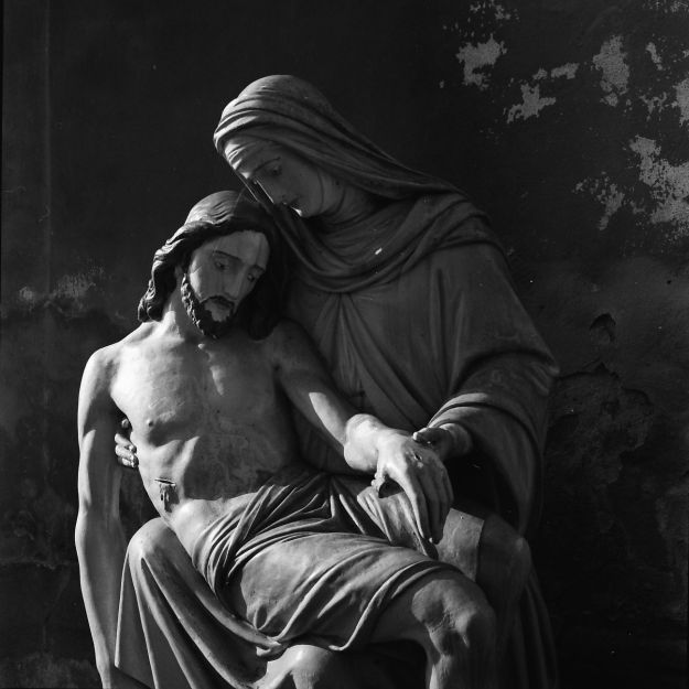

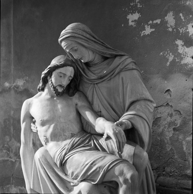

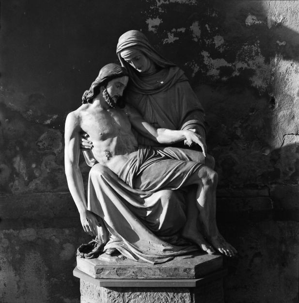

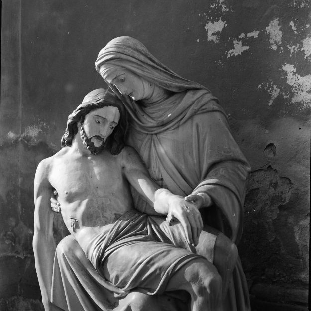

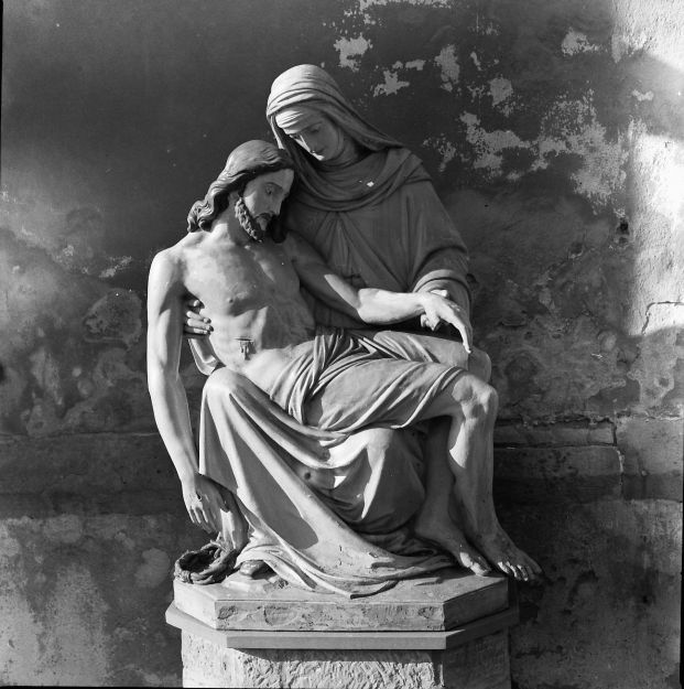

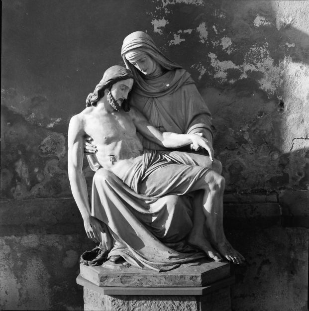

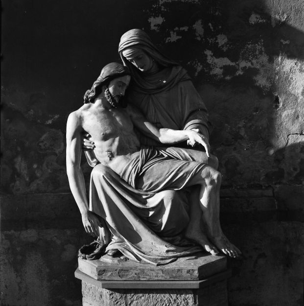

Well, its done.
Took a light meter reading, took a shot, opened up one stop, then another, then another, then another.
15 minutes in Rodinal.
Its now drying in the closet....
As per light meter
one stop more
one more...
one more
Last one...
Looks like a successful experiment. Which negative do you find the shadow detail to be 'good looking and adequate'?
- Thomas

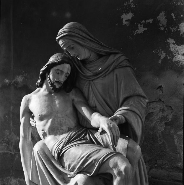

Hi Thomas,
will post the second series... then we can see...
Shot 2
shot 3 and 4
I think 2 stops down is best?
A strange thing to be shooting with film that is probably 20 years over its date... or more....
I like the one stop over exposure best, I guess. Hard to tell on a computer monitor at this resolution, but I think it looks good from here. All the negs seem useful. The ones 3 or more stops overexposed seem to have blacks that are too weak.
- Thomas
