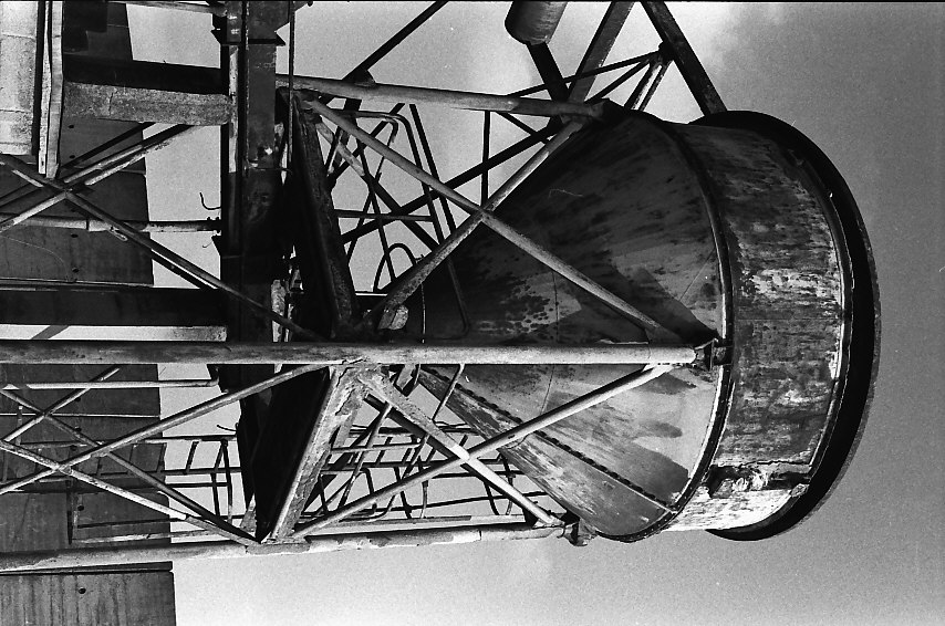

Hi,
Put a roll of expired Ilford HP5 Plus 400 through today.
<Expired in may 1992.
Light meter reading was 125 to 22.
That brought this

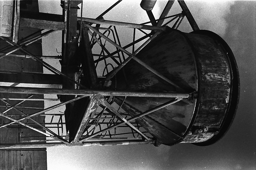

Then tried 125 / 16

I think the half a stop between 11 and 16 is best?
Thanks
Chris
Seabee, in your first shots posted, I think the +1 stop one looks best for the scene (2nd photo you posted). It's a tossup between +1 and +2.
