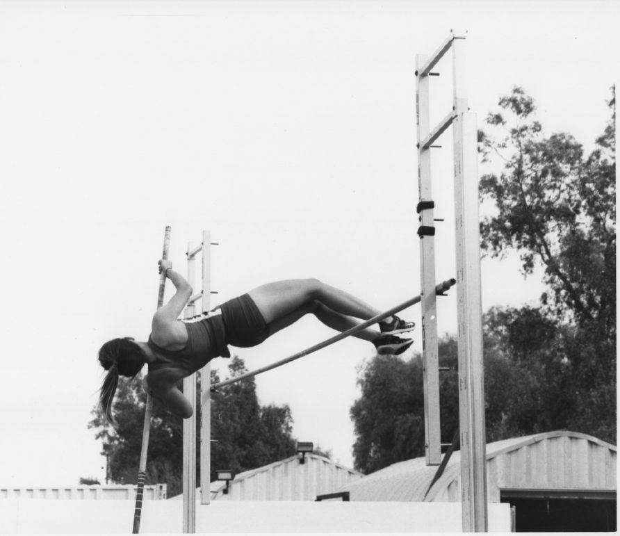

Here is a sample of a scanned print of Ultrafine 400 in MCM 100. UF 400 is not fine grain. Not the best scan, but will give you an idea of good the gain is.

newcan1
Sep 10, 2011
719
Chattanooga
[QUOTE="Paul Howell, post: 2062143, member: 3862"
Here is a sample of a scanned print of Ultrafine 400 in MCM 100. UF 400 is not fine grain. Not the best scan, but will give you an idea of good the gain is.[/QUOTE]
That really is good. I have Ultrafine 400 and it is quite a grainy emulsion. The thing about my Ansco film though is that the grain is not only large but UGLY. I am going to go ahead with my two developer idea this afternoon and see what happens.

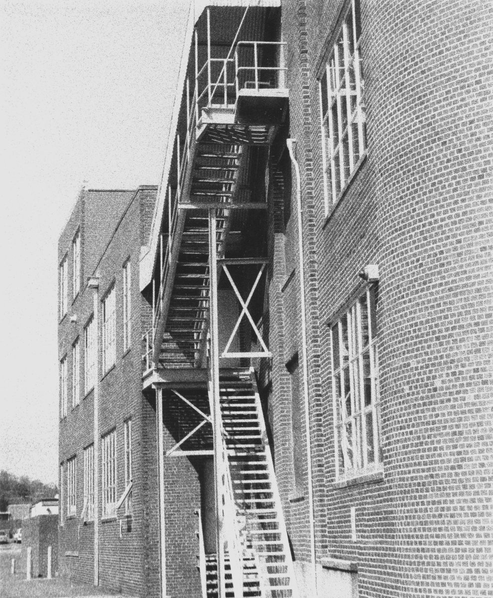

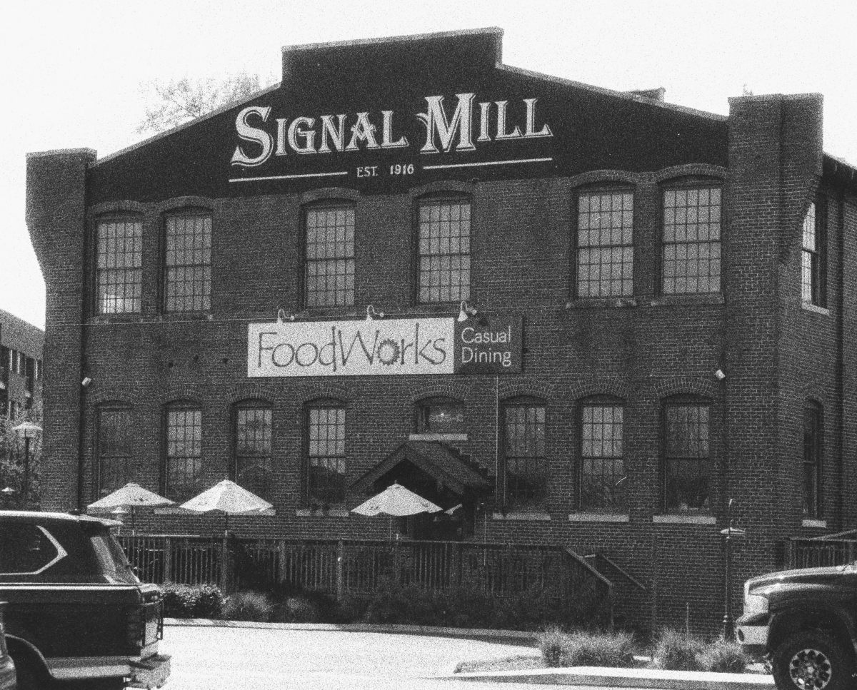

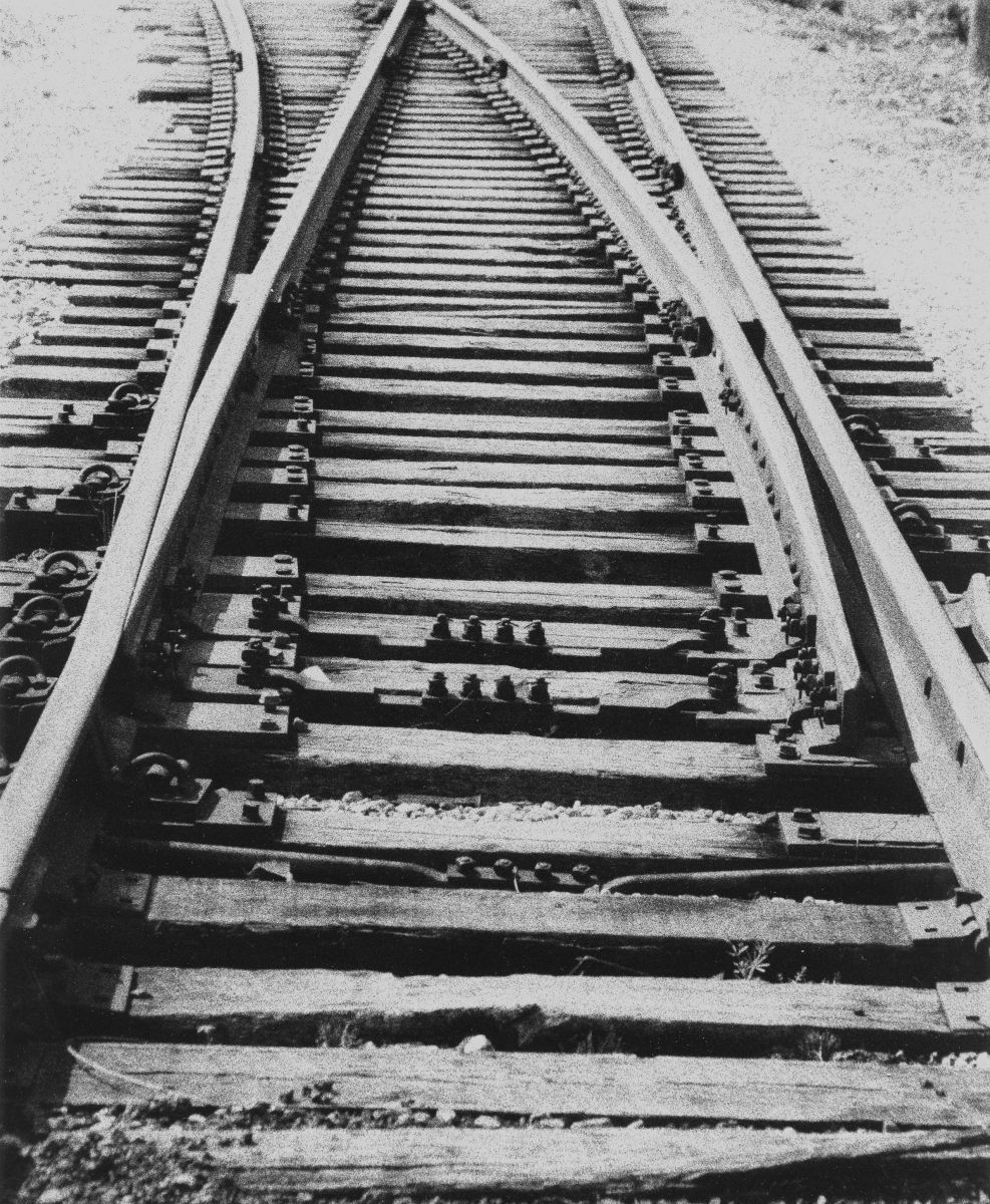

Here are some examples from my 2-developer experiment. The benefits from Perceptol were largely lost, the grain is huge. But it is considerably less ugly; the "look" may have a place somewhere. The D19 boosted contrast. Now I am wondering if I should try D19 with sodium chloride added -- sort of a high contrast Perceptol.
newcan1
Sep 10, 2011
719
Chattanooga
Results with D19 with salt added were similar to the above, although effective film speed increased to a solid ASA 100. For my next trick, I will try Xtol.
