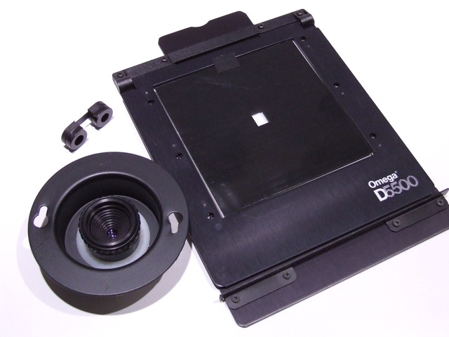

Image is about the size of Minox. Use a glass carrier with a mask.

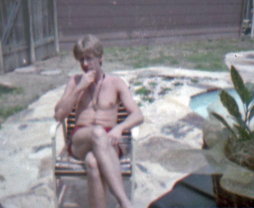

I'm scanning it on my Epson V600 now. The preview looks fairly decent and have hit the scan button. I wouldn't have thought to use the scanner. Thanks

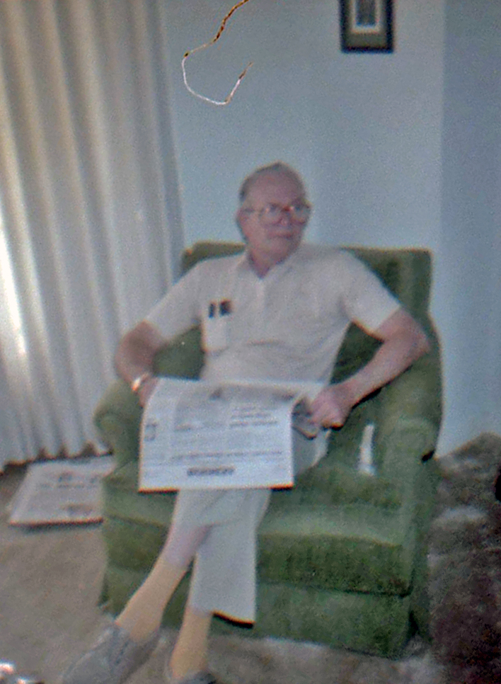

These are two of the better ones that I scanned. The color is not very good and the images have to be rotated and cropped in post processing so I'm being very selective of which ones I am doing. Thanks for the help.

I just laid the disc on the glass in a 120 negative holder, but it also worked without the negative holder. I don't think that the V600 is subject to the focus problems of the higher models. It seems to be fairly forgiving of the negative heights

The Epson V600 scanner will give only about 2000dpi of resolution at best. This means 78 pixels /mm. So a 8x10mm disc film frame, that's about 624x780px of real resolution; and that's even pushing it.
scanned negs
I'll admit that they are not very good, but they are better than not having the pictures at all.
That's more than the old analog NTSC TV sets had.
