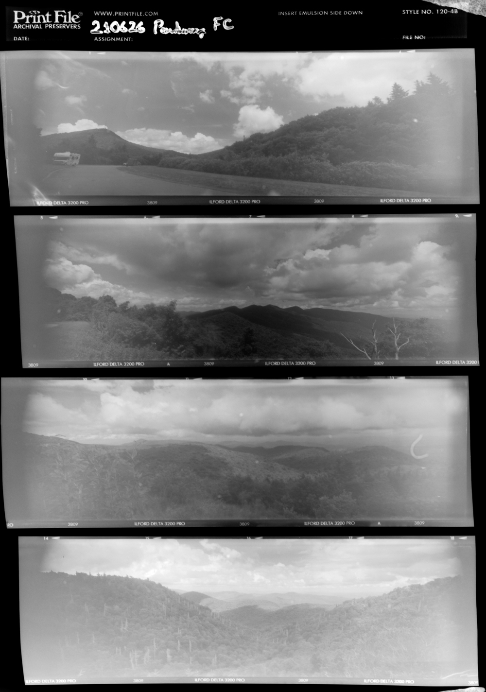

I recently shot a roll of Delta 3200 (exp. 2009 but kept in freezer) on an old camera with which I am not yet familiar. I processed it at box speed in Microphen (9 min. full strength at 20C, motorized agitation.) It came out a bit gnarly--there is what looks like some of the worst base fog I have seen in a long while, and the images are distinctly on the faint side, even allowing for the base fog. Two other rolls of film were in the same developing batch (including a 35mm non-expired Delta 3200 roll) and they came out looking reasonably normal, so I don't think my darkroom technique is to blame. I wondered if it might be a light leak in the camera, but in my experience light leaks show variation--streaks, blotches, gradients, repeating patterns. This is more like a perfectly even, uniform fogging over the entire roll. I guess this film has some serious age issues? I have processed much more severely expired films (including some Konica IR from 1993) and not seen base fog this bad, so I wonder.
I don't want to just toss this film in the wastebasket, as I have about 9 rolls left. What to do, assuming it is the film? I am thinking about pulling the processing to ISO 800 and then shooting the film at ISO 200 to see if that improves things. Is this a rational strategy, or are there other tricks I am missing?

I don't have a proper scan of the roll (and am uncertain whether I will bother) but I do have this index frame. It was shot on a cheap light box with uneven illumination and gives the impression of more variation in quality than there actually is (contrast was boosted in Photoshop a bit.) It is a bit difficult to judge image quality from this, but...
Index Frame 210626 Parkway FC.jpg This image was meant only as an inventory of content, not a record of quality.

Snowfire, grain elevator is right of course there is no way to extrapolate anything from one film in terms of the quality of the others. It is just that the black bag ritual always made me feel better, especially if it was midnight on Walpurgis Nacht and my black cat was in attendance.
Take one pic with all 9 and develop to see how many are OK. The presenter of the site called Shootfilmlikeaboss uses black plastic 35mm film cassette holders for just this sort of purpose.
On the other hand, given what you have now shown us it may not be worth the trouble
