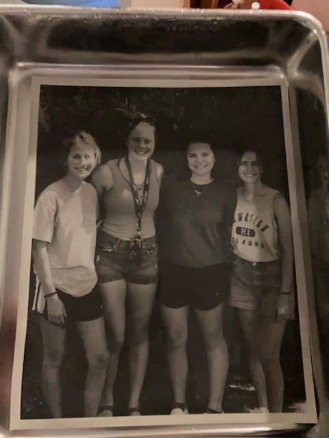

I got the box "AGFACOLOR" from the estate of photographer. He had photographed a lot of color paper. I took and exposed one of the sheets in the box, exposed and processed in Dektol, and it came out OK (a little foggy, but not garbage. So, my question now is whether this is AGFACOLOR or if it is standard B&W paper that just got put in that box?
Looks like b&w paper. Before you exposed it, was it blue? Seems to have too much density for colour paper, though.

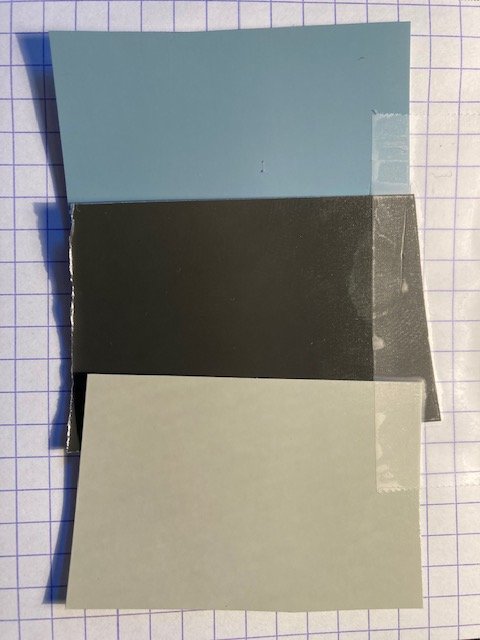

Ok, here is that unidentified potentially AGFACHROME Paper...
It prints, though fogged (see the image above).
It turns my developer BLUE (?).
Attached please find image. First (blue) sheet is undeveloped, out of bag, second is exposed and developed / stop / fix, third (and fogged) is fixed only.
So, is this color paper, or did some form of B/W wind up in the box?

The b&w print you made was on b&w paper. I just don't believe colour paper would give you that contrast and density. The blue paper (and the other sheets, I believe) -- colour paper for enlarging negatives - like Drew said above.

Sometimes old photographic paper changes colour as it deteriorates due to age and storage conditions, so the colour you see may not be a great indicator.
Do any of the papers have a backprint on them?
