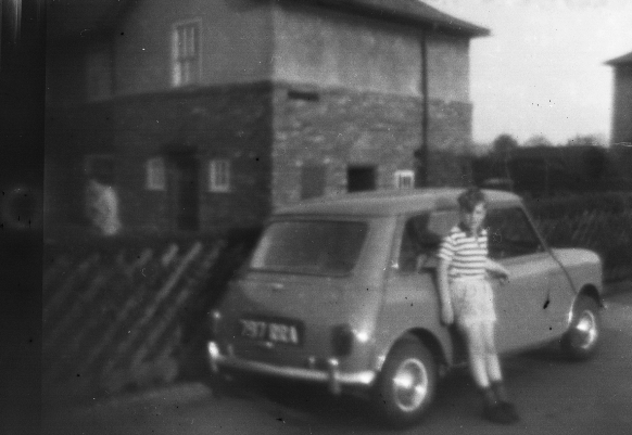

Thanks for your suggestions with this. I should have said that the camera is an Ilford Envoy bakelite 6x9 model, from the 50's. It seems to have a simple meniscus lens and a curved film plane. I bought it on Fee-bay and found this film inside. I have just developed some roll film and did this film in ID11 1:1 at 20'c for 15m. A prewash in water ran dark yellow when emptied out. I was very surprised to find images on it. As has been mentioned here, the film has no marks in the border, all 4 images are very thin and quite soft.
For interest I have attached a scan here. The mini in the picture has a registration number which is pre 1963 (ish), possibly even very late in the 50's, so this picture probably could have been taken in the early to mid 60's. Mini's didn't keep their looks for long, therefore I would doubt that this picture was taken in the 70's, making this 35 to 45 years old?

Very interesting.....we had an enquiry from a guy who bought some stuff from E.Bay from New Zealand, he developed an ILFORD film that came with it and he had some very good images of a late 40's early 50's NZ campsite...as always try and process, we always suggest 10mins in ID11..
The mini ( with proud son of owner ) looks not dissimilar to my first car...which was a 1970 mini, blue and brown ( rust ) which sadly became detached from its subframe and went to mini heaven...but I had some fun in that car.....

I love stories like this - those photos lying dormant for all those years!
If the reg and "A"? if so that puts the car at August 1962 onwards, I think.
I think the mini came out in 1959? and the modfel shown does look like an early model - Also, so does the hairstyle.

Thanks for the comments. Simon, would that be a recommendation for development in ID11 at 10 mins at stock strength?
Matt, the reg number is a little unclear isn't it. The last letter looks like an "A" but the format of the whole number is not correct for an A reg car, I think. but as you have said, either way it would be early sixties.
