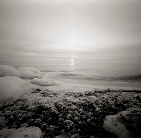

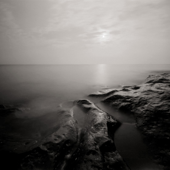

Sample pictures
Both are Plus-X in 120 format from a pinhole camera.
In the prints I can see a little bit more grain from the Rodinal negative and a bit more highlight intensity.

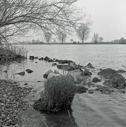

OK I went for a Rodinal 1+50 13:00 minutes for this PXP film E.I. 100.
The biggest problem was a regular load in the reel because the 120 roll film was pretty curling after so many years in the package.
Good negatives.

I am so happy Rodinal worked out for you, Robert! Can you show us some examples?
I had the same problems with the film curling after many years of storage. But after processing they straightened out nicely!

Not too bad for a film that's almost as old as my cat (who is very old). If there is fog I don't see it- and if so it might have even helped the shadows.
In just a month's time all those trees and bushes will be happy & green again!
