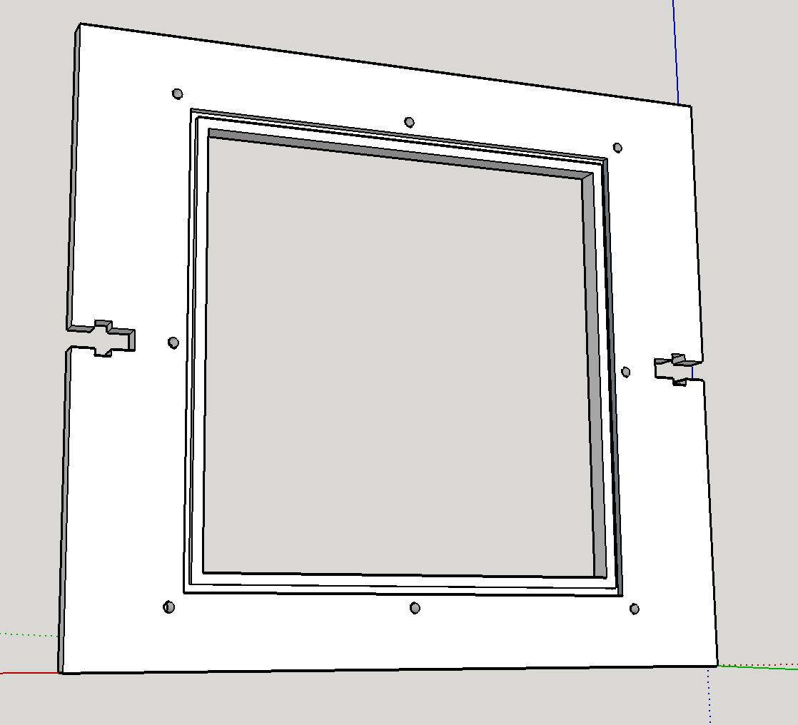

I personally am building a large format camera from scratch and need to figure out how to "manually" control the sinar board aperture. I have the correct angles for certain aperture mapped out, but I need a control for the lever which is behind the lens board. Lens board is complete so mounting the lens is not a problem.
Here is a 3D model of my board, the holes are for the board clamps which locks the sinar board in place.
