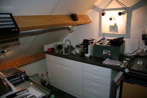

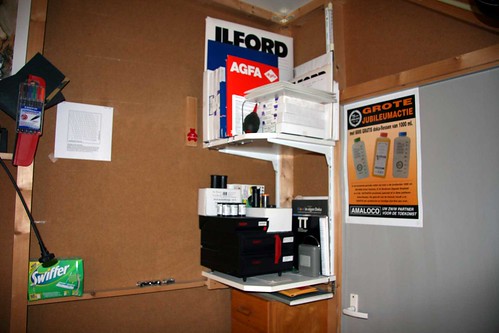

If you stay with 35mm I would go for a V35 and a Nova vertical processor. Both very compact and suitable for high quality prints. Prices of second hand enlargers came down tremendously so i think in Germany or Holland you can pick one up for less then $250 and a print Pod (8x10" - 20x25cm) for maybe $20. If you would go for a Meopta Axiomat it's here old steel price.
I didn't even know about vertical processors, thanks! But looking at the price, I think I see a DIY project here
Yes, the heated ones are expensive but the print Pod not. Very simple system and for that price you can not DIY. I have the Nova Masterlab 4x print Pod and then heated for quick work, 4x 0,9 ltr.
Otherwise I am using a Jobo CPA-2 with elevator but this unit is outside my (small) darkroom.

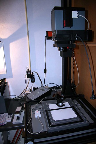

The Heiland Split Grade is certainly a very sophisticated piece of equipment. Can you give us a quick sense of how you like your unit? Is your Split Grade set up so as to move the filters automatically?
Yes, all dedicated Split Grade enlarger systems are turning automatically. In one measurement you're doing exposure time + gradation (at work aperture) , darkroom lights are automatically switched (off and on) , and the system is pointing out in 0,1 gradation steps the exposure in Yellow and Magenta (or vice versa, which you can program). Very fast and reliable. 98% is perfect in the first run. It saves a lot of paper and time, especially on fiber prints. Further you can print with short times while there is no lamp which has to glow on/off.
