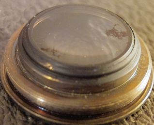

Bill Burk
Feb 9, 2010
9,328
The one time it becomes a catastrophe is when there are drops and these land on a lens surface. Then the oil can damage the coating if left too long.
I had a camera where this happened twice. The first time, was when I got the camera and I had the lens polished professionally. The second time the problem appeared I was not interested in having it polished again, so I sold the camera on eBay (with really, really, clear disclosure of the defect) and it became another person's problem.
Here is what oil on lens damage looks like:
