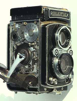

I thought about it once, then I saw a photo of an "undressed" Rollei. That mechanically savvy I am not. Unless you have a lot of skill, I wouldn't recommend it..
