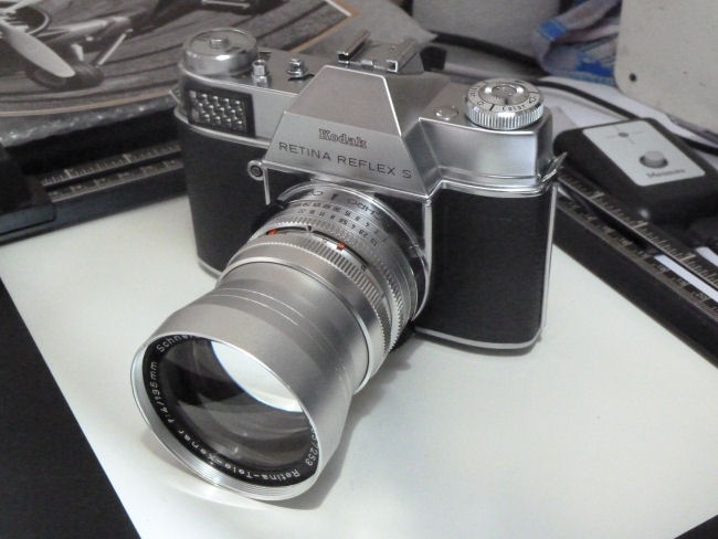

I really, really don't need this, - I already have a Retina IIIS and 3x lenses. Just for a lark I bid £5 on a nice looking Retina Reflex S... and won it for £3.76 plus a few quid postage. Sold as spares or repair, Apparently "it was working until the rewind jammed and the mirror stuck up". I see from the photo the counter is down to zero. I wonder........... Place your bets :tongue:

Result! :smile:. It came, and is in great condition but was definitely ill. In for a penny, I started lifting the top - prism off - meter off, and watched how it worked. Realised the mirror wasn't latching but everything else seemed sort of OK. Lo and behold, I spotted the loose end of a hairspring on the mirror latch. Reachable through the film plate window- reseated, and all is good! Firing nicely on all speeds. Prism and focus screen needed disassembly and a clean, and it's looking good. Think I'll put a film in it tomorrow and have a test. It's a far better camera to use my 135mm lens on - this is virtually unusuable on my IIIS because the viewfinder area is so tiny.
