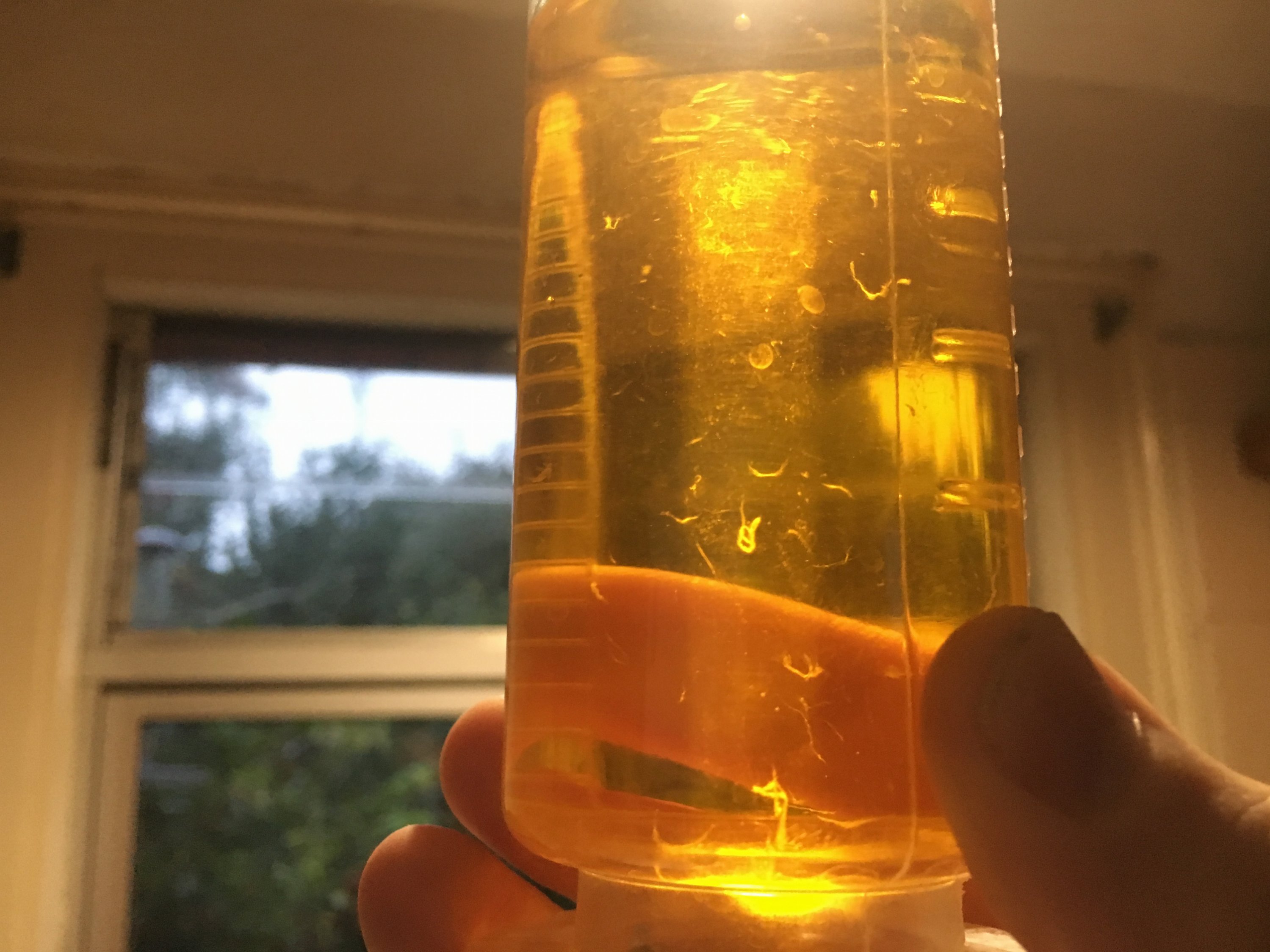

I had a bottle of odourless citric acid based indicator stop open (the concentrate). It has been open for about 6 weeks. I went to mix up some working solution today and noticed strange gelatinous filaments in the solution. I realised I could not use it like that so I phoned the company and spoke to their technical chap. I was told that microbial growth can occur in citric acid stop unlike in stronger acetic acid based concentrates. I was advised that I could carry on using it if I filtered it through a coffee filter. I said thank you, put the phone down, threw the old stop away and opened a fresh bottle.
I think I may switch to acetic acid based stop in future. I only used the citric acid type as I was processing in open trays in a poorly (not) ventilated darkroom. Now I have a slot processor and there is no good reason to be using the odourless stop especially as it seems to go bad quite quickly.

Bacteria and Yeast can decompose Citric Acid.
Yes they can use it as food. Actually we can metabolise it too, it's called the Citric Acid Cycle and is absolutely essential for life (Kreb's Cycle). I never really did pay enough attention to undergraduate biochemistry.... I thought the concentrate would be too strongly acid to support microbial life. Evidently not.
Incredibly bad advice from the manufacturer. If the microbes are capable of chewing up citric acid just think what they can do to a gelatin based emulsion. Does anyone want to infect their film or prints by attempting to use this stuff.
Yes, I thought that too which is why I have thrown it out. I think I am going to switch to a highly concentrated acetic acid stop concentrate in future. The indicator feature sounds useful but really is not very useful to me; I never use the working solution to anywhere near exhaustion. I use a slot processor and all of the chemical baths are replenished at the same rate so exhaustion is not going to happen.

Citric acid stop baths are excellent media for some bacteria. You may be seeing the beginnings of a culture. I once had a tray develop a full grown culture over about two days.
