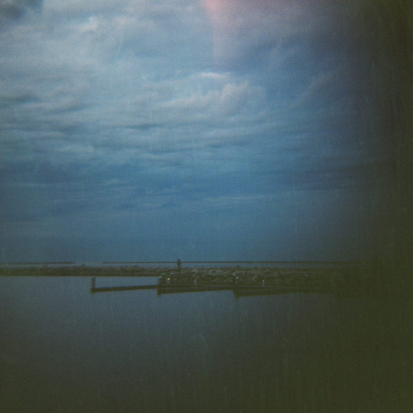

Hello! I have had an issue with streaks appearing on underexposed films recently and was wondering if anyone had any ideas as to what could be happening.
My process is this:
Develop with Fuji Hunt Chems in Patterson tanks, bleach, wash with tap water, fix, wash with tap water, then final rinse with flexicolor final rinse and a bit of photo-flo.
It seems to happen mostly near the end of the roll, and is especially bad in thin areas of the negative.
Any ideas?
koraks
Nov 29, 2018
23,710
Europe
The first thing that comes to mind is insufficient agitation. Keep in mind that the C41 process was engineered with constant agitation in mind; you'll have to try to approach that as closely as you can with the Paterson tank.
NewDarkroom
Nov 4, 2022
10
USA
That is a real possibility, it doesn't happen all the time. But especially on thin negatives or in thin spots of a negative.
I agitate for 10 seconds every thirty seconds with inversions.
koraks
Nov 29, 2018
23,710
Europe
Do you start with 30 seconds continuous agitation?
Don't invert too cautiously; keep in mind that the purpose is to replace developer at the surface of the film with fresh material, so it is OK if it's a little fierce (without splashing liquids all over the place).
NewDarkroom
Nov 4, 2022
10
USA
Yea, I do the first 30 seconds with the twizzle stick so that I can do it right away before fumbling with the lid.
I also thought that this might be caused by over agitation? Like the chemicals surging through the reels might streak it.
Or potentially a weak bleach not stopping the developer quickly enough?
koraks
Nov 29, 2018
23,710
Europe
The twizzle stick may not be effective unless you're rather violent with it; if you're rotating it carefully, you're probably not doing it right.
No, I don't think so.
Perhaps, but again, I don't think so. If you wonder about this, try a stop bath (which I'd recommend anyway) of 0.5% to 2% acetic acid.
