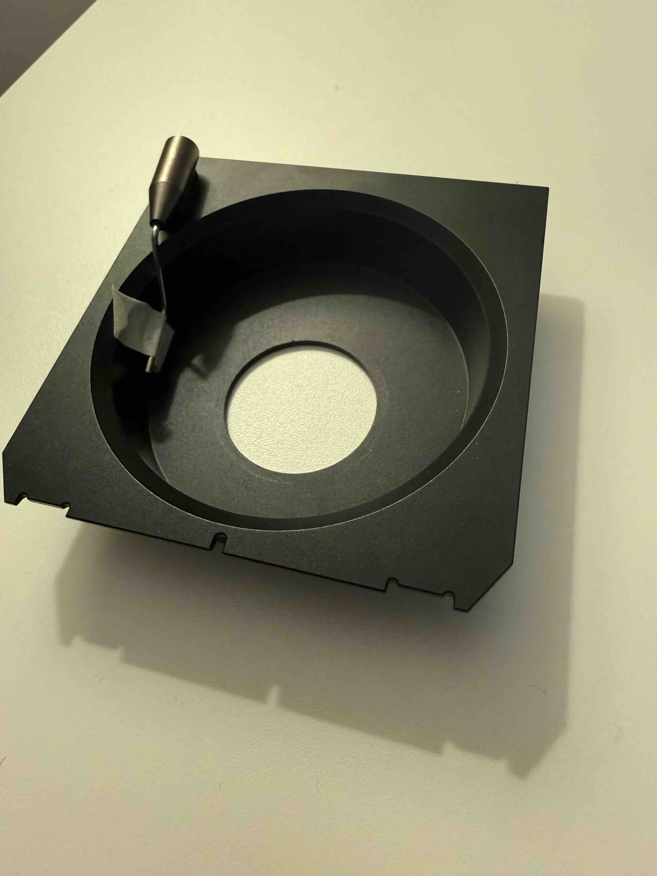

I have this wonderful lens and I'd like to start using it on a panoramic camera. The problem is the bellows won't compress enough to get my to infinity, so my first instinct was to get a recessed lens board. I bought one of the generic ones and am having the weirdest time trying to get it to work. The problem is that when I mount the lens to the board (21mm), as soon as I cock the shutter, it fires, no delay. I checked to see if I was accidentally triggering the release level, but no. I took out the little "pin" that allows a cable release to connect on the front side of the board. It's definitely not that. What could I be doing to trigger the shutter? I mounted it back on it's original board and unmounted and it behaves normally.
Here you go. I showed the area of the lens that would be interacting with the board.

Sometimes cocking a shutter will move the release lever. Maybe cocking is moving the tip of the release lever into the recess wall and preventing it from holding? If so, you could grind back the end of the lever a bit?

Thanks for responding. I checked this and the release lever is far enough above the wall of the board so that it can move (and release) freely.
When the lens is mounted in the recessed board how much room is around the lens? Does the tripping lever touch the wall of the recess? Does your lens have the locating screw on the back, can't tell what with the retaining ring covering the area where the screw would be. If it does have the locating screw and you mount the lens and tighten the ring it could distort/distress the shutter housing enough to trip the shutter when you attempt to cock the shutter. If the locating screw is not there then something else is causing the malfunction.
