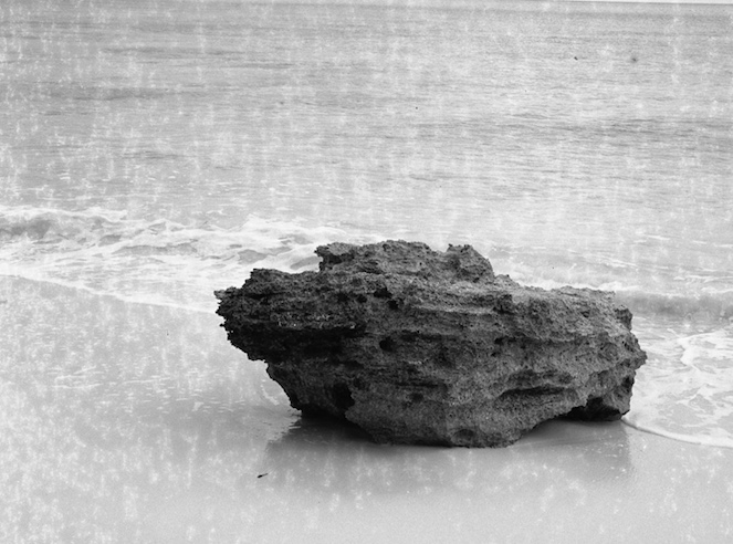

Can anyone tell me what this may be? So far I've got it on two rolls out of the three I've developed. New film, unwrapped and loaded in high humidity location, shot within a day or two of being loaded into camera. After it was shot, it was tossed in a ziplock bag for a few days. Then it was flown back to the states in my backpack, moving in an out of air conditioned locations. Film: Ilford Delta 400 developed in HC-110 and Ilford FP4 developed in Ilfasol 3. Both show the same pattern. Humidity? x-ray damage? Bad stop bath? Fixer was new-ish.

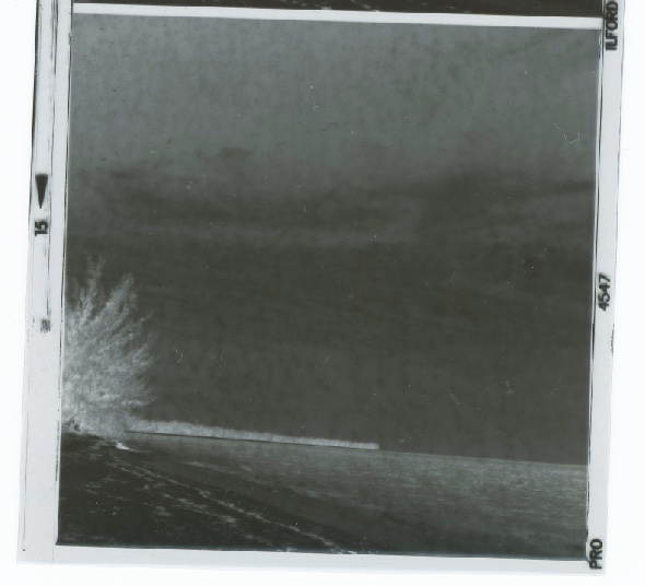

Someone mentioned film mottling due to humidity/condensation and emulsion sticking to backing paper. It was in a tropical environment, so maybe that's it? Here's a photo of a different negative with the same issue.

It has all the hallmarks of the backing paper on 120 film interacting with the emulsion due to high humidity and/or changes in temperature.

The hypothesis in a private thread with another user seems to be that I put the exposed film (all new stock, never refrigerated) in a plastic bag while still in a hot, humid environment, and when I ran through multiple airports and lots of air conditioning on m way home, the humidity in the bag had no where to go besides into the film/backing paper/emulsion. Lesson learned, I guess.

If the film went into a sealed bag in warm, humid conditions, and was then subjected to cooler temperatures and reduced pressure (air travel in the cabin), there is a good chance the conditions inside the bag crossed the dew point and there was condensation. The film and the backing paper would absorb some moisture, and it would have little chance of escaping in the closed environment.

Yep, this is what I now believe happened. I live in cold NY, and I'm used to stuffing things in plastic bags before bringing them inside to slowly come up to temperature, with all condensation happening outside the bag. My first experience bringing old film cameras to the Caribbean and I did the same thing, but I shouldn't have since the moisture was all on the inside and I apparently trapped it there.

This sounds plausible. When you go from 90°F actual temperature and 80°F dew point to cold temperatures it's reasonable that you could have a "fog" of water condense on the rolled up film. I'm pretty careful, but I've taken 120 film from a refrigerator and loaded in a camera indoors without a problem. I've never gone from tropical to cool conditions with unwrapped film that I really recall.
But if the film and paper were holding water vapor in a steam bath like environment, and it got cold you are going to get condensation.
