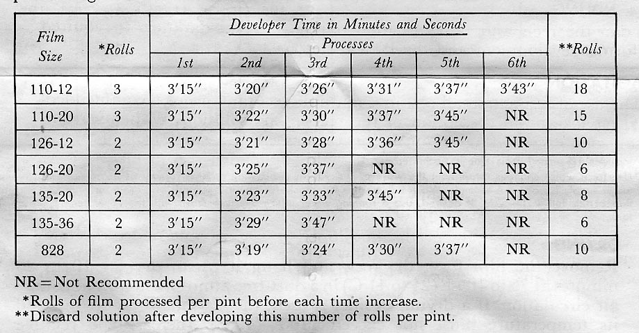

There is another and better reference which gives the method for reusing the developer. Basically, you extend the development time for each roll or group of rolls.
You may want to check that reference out as well.
PE

Do you have a reference for this? I looked at all of the Kodak docs available from their website and didn't find anything about extending the development times for C-41. In fact, all of the C-41 papers explicitly stated that one should never reuse the developer (for small quantity processing).

well, good thing I copied this!
This is from the C41 process manual. The data is missing from the Kodak web site, but I fortunately have it in my archives.
Oh, you owe me. I posted this several times before. :D :D
JK.
PE

Ahhh I found it!

Great! Thanks very much.
wn
ps. For 120 film (12 exposures), do we use the 126 entry?
I can answer that.
The times relate to the area of the film. 120 film has the same area as a 135-36 roll.
