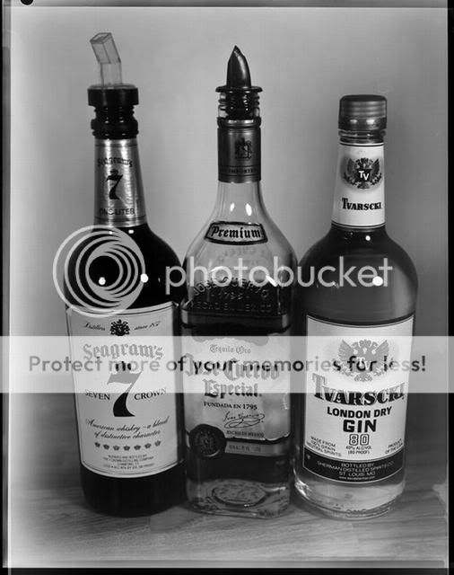

Hello:
I acquired some Kodak Ultratec UGF (open box, TBD what's really inside it) and
#1 Network (numberonenetwork.com - didn't find it on line)
#470 HP RA/Lith film.
I see Ultratec UGF described online as what I would assume to be 'ordinary' graphic arts lith film.
I would assume they are similar as the user had both at the same camera.
HP I guess means high performance...whatever that means.
RA I guess is Rapid Access type chemistry.
Are all or most lithography films about the same, or is there all kinds of variation?
I didn't find an expiration date on the Kodak, but the #1 Network stuff is unopened, stamped 11-06 (mfg?) "Use by 11-08".
Red safelite, so it's ortho (as I expected).
I have chems to make POTA and I think probably Delagi #8.
Any suggestions for in-camera ISO and developing starting point (for contone, not high contrast.)
Thank you
Murray

You can get continuos tone with Dektol, LC-1 or HC110 dil H for several mins. (DBI is warranted) Start with an EI of about 6, shoot some zone I exposures and aim for a density of .1 over Fb+F as a start. develop as needed to get the CI you want. It's not rocket science, and and no different than EI deterimination for any other film, just lower numbers.
Ortho film has some interesting properties, as well as a unique signature for landscape and detail type shots. Of course Murray already knows this, as he and I have had this conversation before and he already uses several lith films (or is it xray film??)

I also will add that Polychrome MCE film work quite well for contone work:
exposed at EI 6, processed in Dekto 1:6, by inspection.
