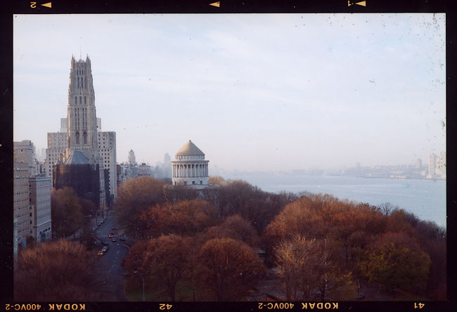

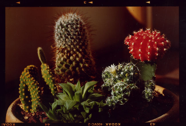

Okay, I got my VC400-2 and NC400-2 tests back from Duggal (note the new edge marking to distinguish these films from the earlier Portras). Grain is excellent for a 400 ISO film for both of these.
These two attachments are VC400-2, 6x9cm using my Linhof Tech V 4x5" and a 6x9 Super Rollex back. I think I used the 150/4.5 Xenar for the macro and a 75/4.5 Grandagon-N for the landscape. These are both scans from the contact sheet (sorry for the schmutz under the scanner glass) on Endura.
With the VC400-2, I found it was easy to exceed the contrast range of Endura in contrasty light, so if you plan to print by projection and don't want to deal with contrast masks, then consider this a film for flat lighting conditions.

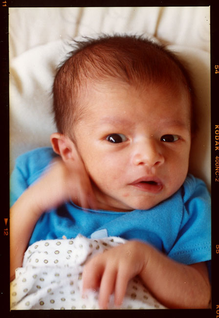

Here's a scan from the NC400-2. Here I was using the Linhof Super Rollex 6x9 back on a 4x5" sliding back on a 4x5 reducing back on my 8x10" Sinar P with a 12"/6.8 Gold Dot Dagor at f:8, 1/10 sec (how's that for overkill!). Natural light from a large window. The full image is from the contact sheet on Endura. The detail to show the grain is a 1000 dpi scan from the neg.
I think this is a definite improvement over the old Portra NC400, which I didn't shoot that much, but I like this better.
Can't wait to test out the 160 speed films. I've got one roll left of the old NC160 in 35mm, so I'm shooting it now for comparison.
