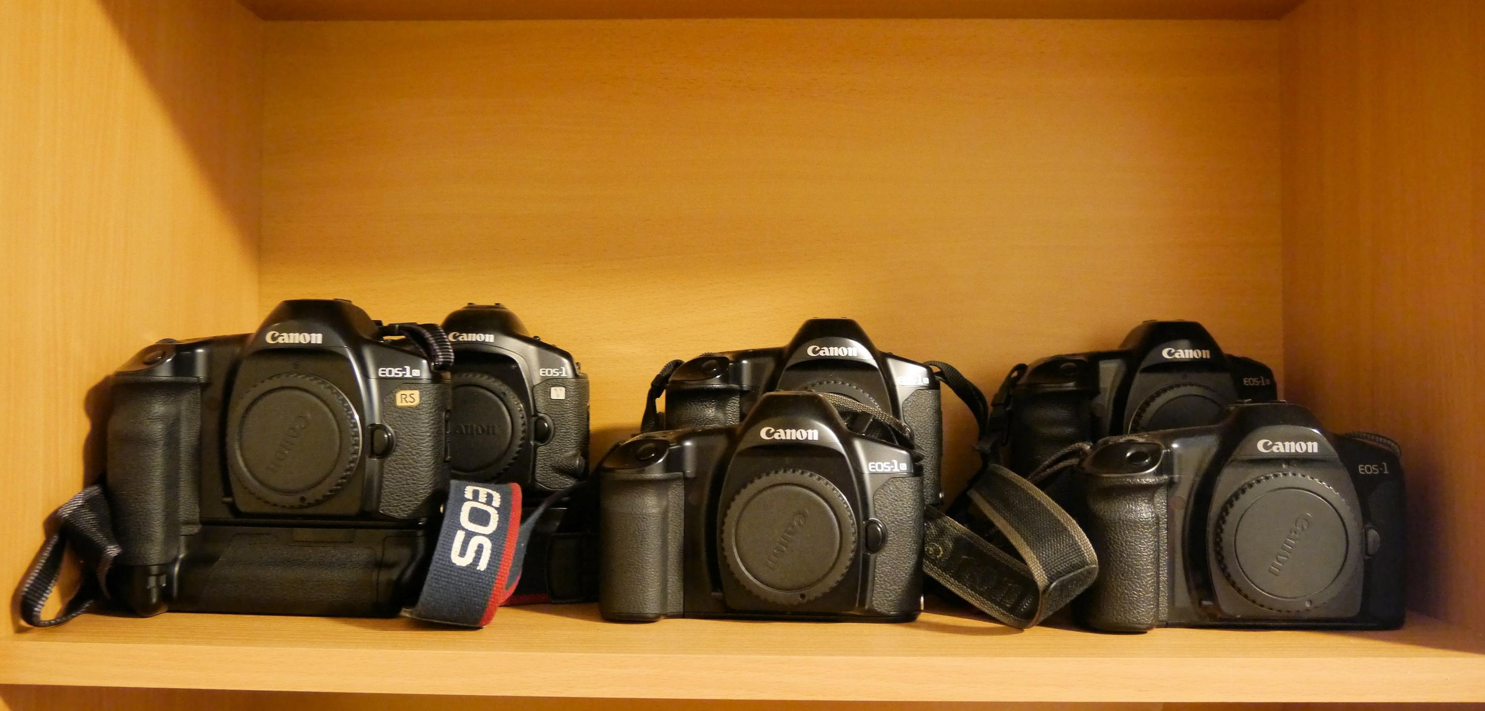

Now my collection of EOS 1n cameras is almost complete.

I have bought an Eos 1n RS the EOS-1N RS has a fixed, semi-transparent mirror for up to 10 fps). I have heard that there other special edition of the Eos 1n series, but i am not sure what type of cameras that is.
