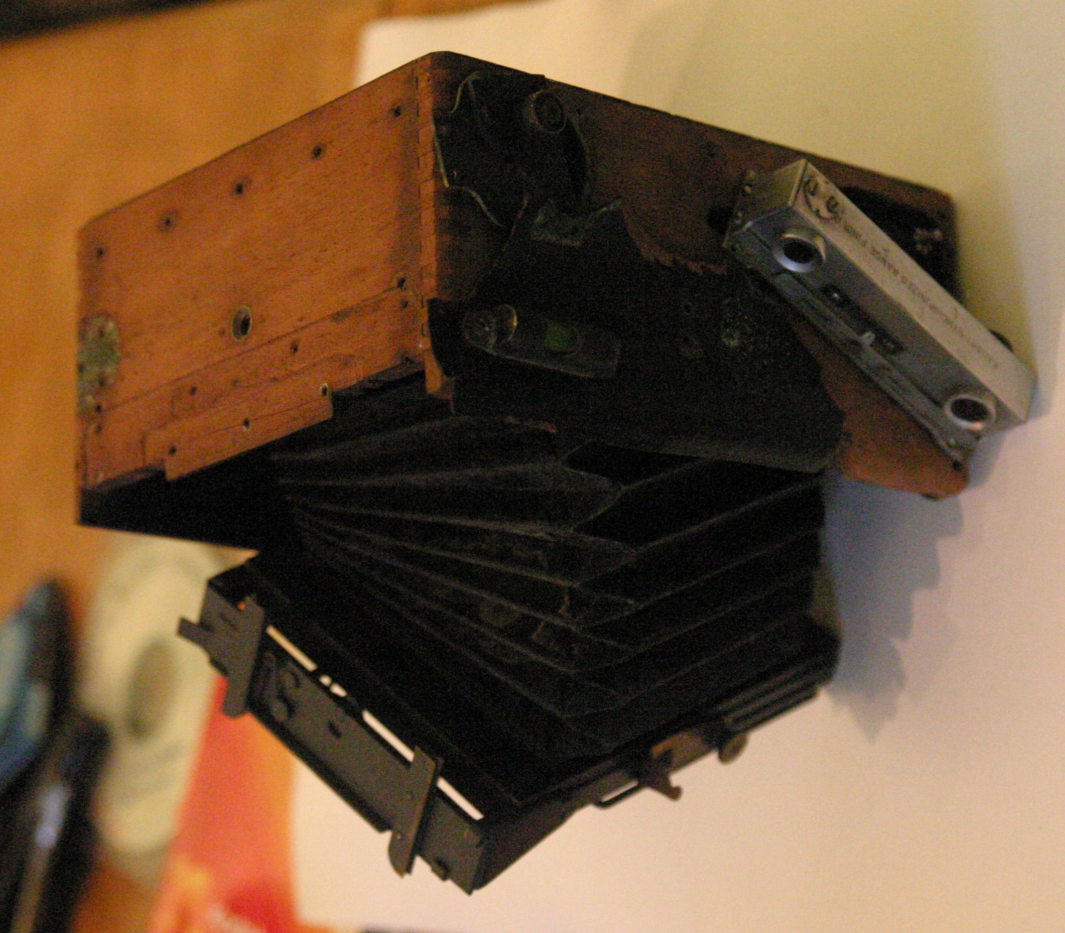

And my pre-Anniversary Speed Graphic looked like this :unsure::unsure::unsure::unsure::unsure:
but is now fine, and the shutter's smooth,although the body's naked :D

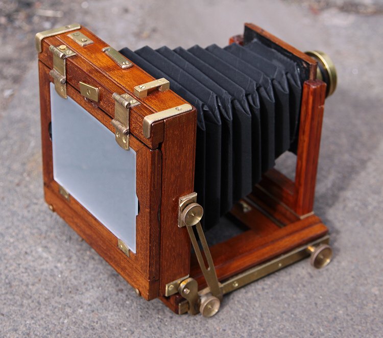

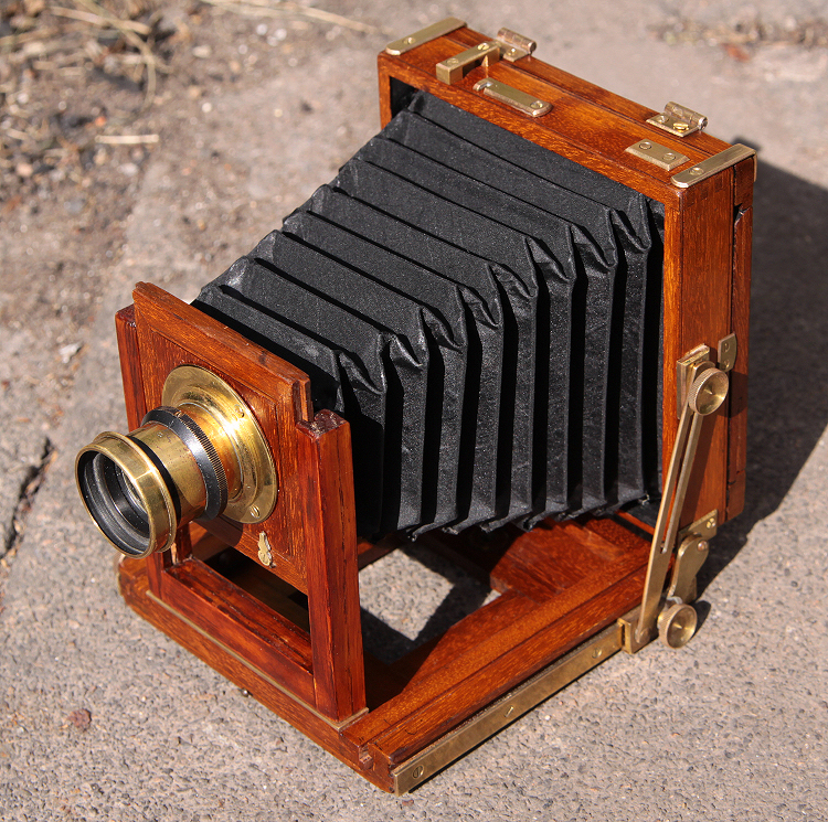

This is the Houghton's 1/4 plate Victo, it really needs a carrying strap fitted & re-photographing as it was still missing a couple of brass fittings as well.
I've made some adapters to allow me to use a Graflex 6x7 roll film holder with this camera and modern 5x4 DDS with the Houghton's Half plate Duchess. The great thing about these cameras is it's easy to make lens boards and fit different lenses, add shutter, even fit different backs.

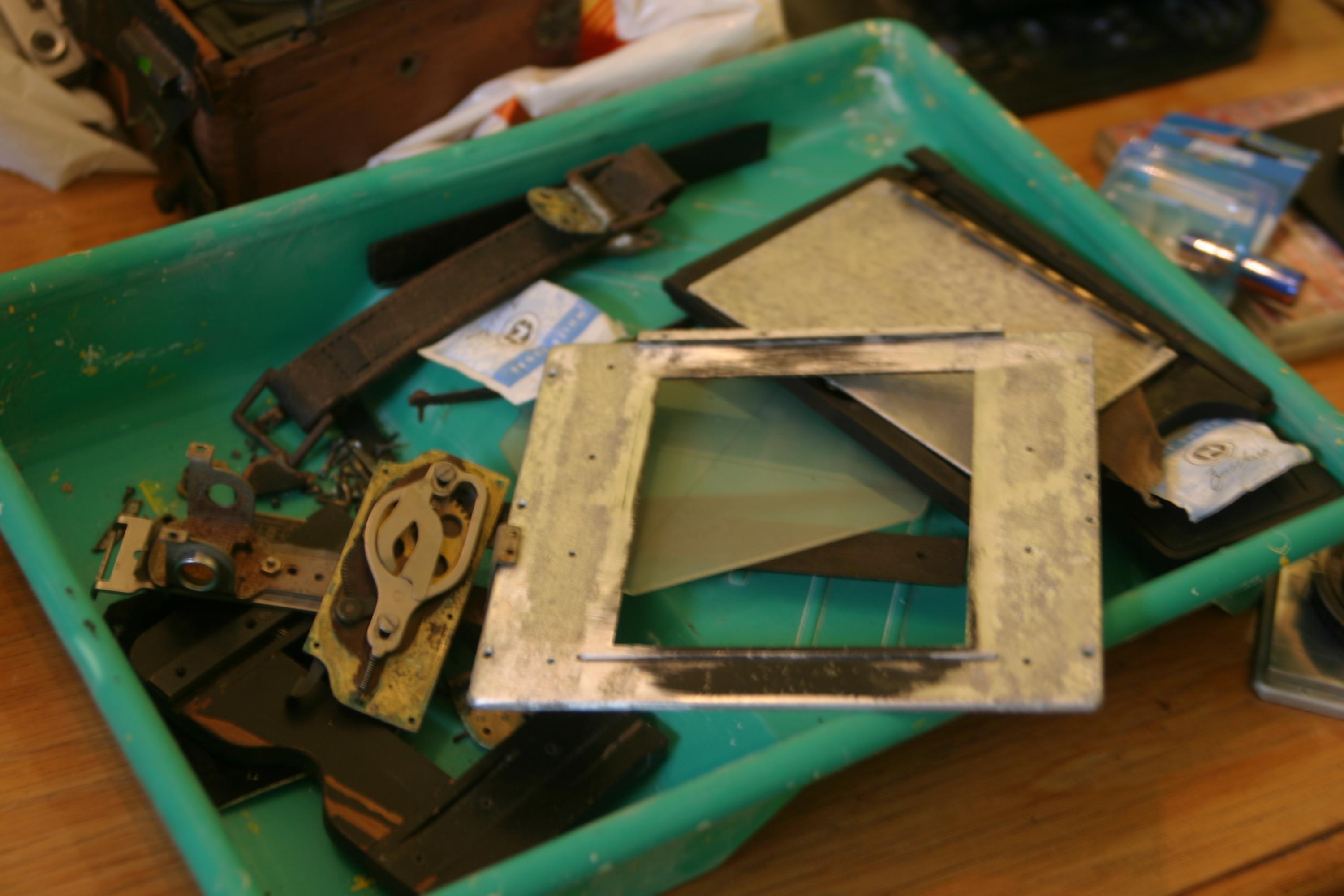

Here's a few pictures. I have a LOT of these - the full strip down sequence. Then reassembly. Then strip down. Then reassembly again. Then strip down - and finally a picture of a box of bits :sad:
Here is a picture of the original shutter curtain (right) and my first attempt at making a replacement. (It is a bit ragged around the edges and the top lip isn't very tidy. The second and third attempts were much neater, but no more successful)
At one point I got the shutter working outside of the camera. It jammed up (again) as soon as it was re-assembled...

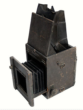

The camera arrived this morning, a Thornton Pickard Ruby Junior Special, Quarter plate as I'd guessed. I was hoping to be able to just clean up the casing with some minor patching but it'll flake off when I open the camera up to take the shutter mechanism out. There's also a crack in the wood of one side that'll need glueing up so I've ordered some Moroccan Grain Black leather cloth.
I've already cut a new focus screen and am now contemplating what to do with the front surface silver mirror. Judging by the silver on the edges and a bit on the rear as well Thornton Pickard made these individually which made me realise if they could make them then so can I :smile:. I have some Silver oxide, ammonia etc so will give it a try, just need to rig up a hot-plate outside.
Before I begin stripping the camera down I'll shoot some photos of it.

You won't have any trouble stripping this down, it is quite easy, but here are some pics of those 'sneaky' hidden screws I promised you.
Basic strip down sequence is to take the back off (three screws at the bottom and two at the top, I think?), remove the knob (screw at the base of the knob. It passes through the threaded shaft so need to be removed completely). Pull off the knob, four screws to remove the wooden plate covering the gears.
There is a mirror return spring which needs unhooking at one end, too.
There is a light trap between the top of the shutter and the body which is glued in place (you see it hanging down in the last picture). On mine the glue was so old and dry it pulled straight off. If yours is stuck more firmly it might need a little acetone or careful peeling off.
Undo the four screws in the pictures (one onthe left side, one at the bottom, two inside the timing gear housing) and the shutter should pull straight out the back.
You can pretty much jump in and pull it apart. No nasty twangs and things shooting across the room, or bits falling out before you can see where they've come from. There doesn't seem to be any need to mark up positions of knobs or anything, either. Just dive in :wink:
